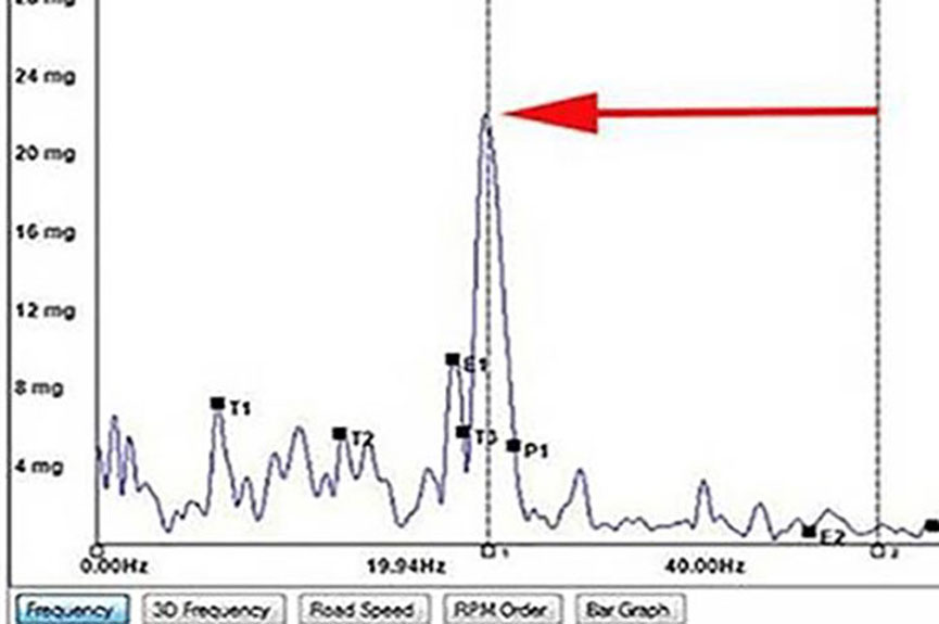

A shudder condition may also be a chuggle, surge or vibration condition. Use GDS 2 or the CH-51450 PicoScope to confirm that the concern is TCC shudder and not a tire/wheel vibration or a driveline vibration, for example. A screen print from GDS 2 or the PicoScope showing the TCC shudder event must be attached to the Repair Order hard copy. (Fig. 12)
If TCC shudder is present, a vibration peak will appear within +/- 2 Hz of the frequency listed in Bulletin #18-NA-355. Refer to the bulletin for additional information, including required shudder test conditions for each vehicle being diagnosed as well as the fluid exchange procedures.

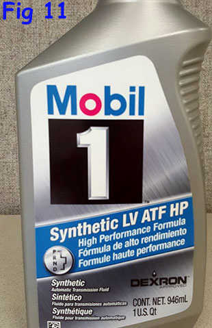

Quart bottles, which can be identified by a new blue banner across the front of the bottle (Fig. 11), will be limited to 20 cases/120 quarts per dealer per week during the initial launch of the new product. The new bottles also feature the HP license number J-62120 on the back label.
