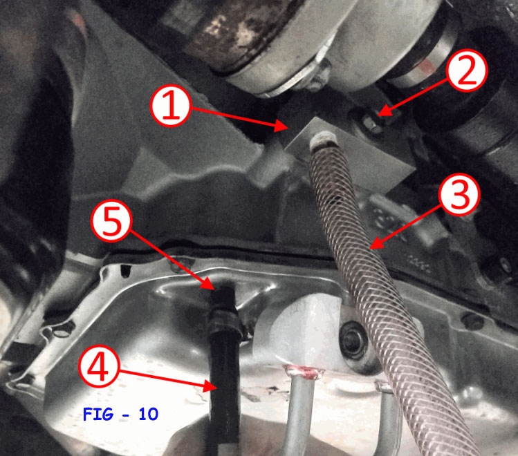

The new fluid exchange procedure requires the use of the DT-45096 TransFlow Cooler Flush Machine and DT-52263 Transmission Fluid Exchange Tool Kit. (Fig. 10) The tool kit began shipping to dealerships at no charge in late January 2019. All GM dealerships should receive the tool kits by the end of March 2019.
