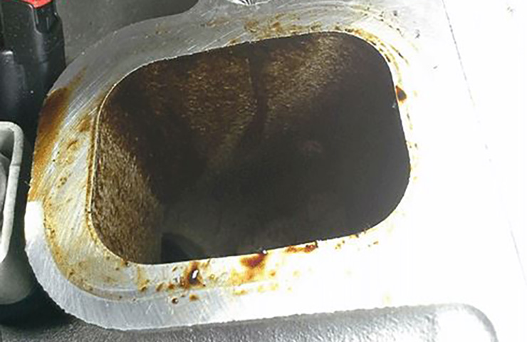

Misfires on start up only, with high rates always on one cylinder, can be suspect for coolant entry at the liner-to-deck face casting or the casting line in the intake port of the cylinder head. To inspect for this condition, add coolant dye to the cooling system and warm up the engine to pressurize the cooling system. After warming the engine to operating temperature, let the engine cool overnight and then inspect the suspect cylinder with a borescope for coolant dye evidence. It may be necessary to remove the head for inspection.
If the head casting line is the issue, the intake port will be wet with a coolant and oil mix. This condition may cause the running rough while warm concern with or without DTCs set. The location where the coolant is running down in the port will look washed down. If this condition is found, the cylinder head will need to be replaced.

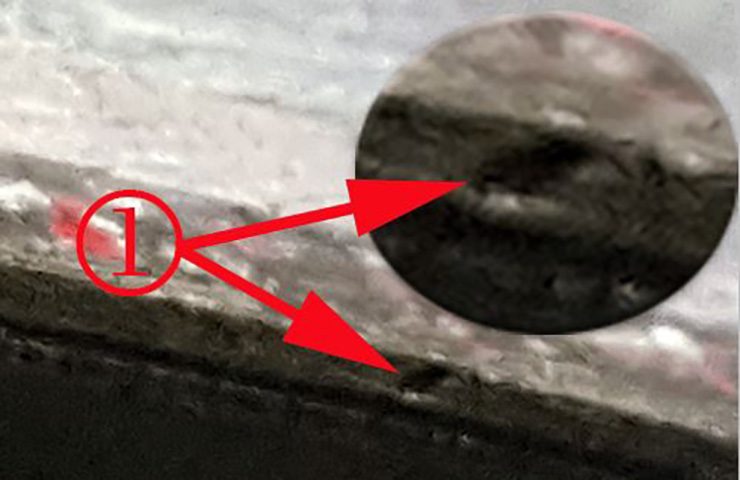

For coolant entry at the liner-to-deck face casting of the cylinder bore, it is hard to see the actual source (pin hole), but it usually streams down the liner so it may be seen with a borescope. The top of the piston will be steam cleaned.
Do not confuse residual fuel on the piston crown/surface as coolant. Some fuel residue may be present and can be mistaken as coolant, which is the reason for the cooling system dye to be added. Use a black light to confirm the liquid is coolant. If fuel residue is present, do not replace the cylinder head Refer to the latest version of Bulletin #16-NA-338.
