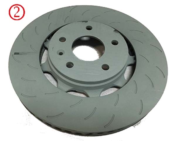

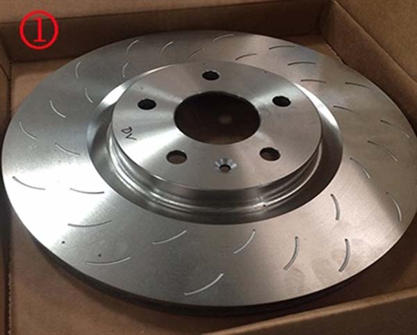

Brake rotor assembly design has been changed from a two-piece to a one-piece design.
For front rotors and vehicle built prior to May 31, 2016, replace the old two-piece design with the new one-piece design.
For rear rotors and vehicles built prior to July 23, 2015, replace the old two-piece design with the new one-piece design. Rotors must be replaced as pairs (both fronts and/or both rears).
