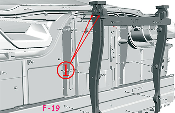

To correct the position of the rear spoiler, remove the rear fascia and adjust the Rear End Secondary Spoiler Bracket (Fig. 19) as needed until the spoiler is level.

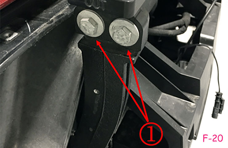

The bolts that need to be loosened to perform the adjustment are located on the left side of the bracket. (Fig. 20)

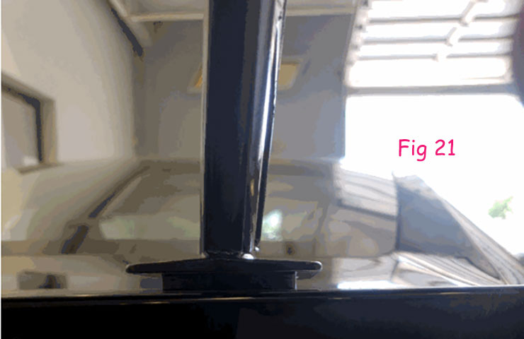

Adjust the spoiler so that the spoiler mounting piers are even left to right and are a minimum of 3 mm above the rear fascia. (Fig. 21)

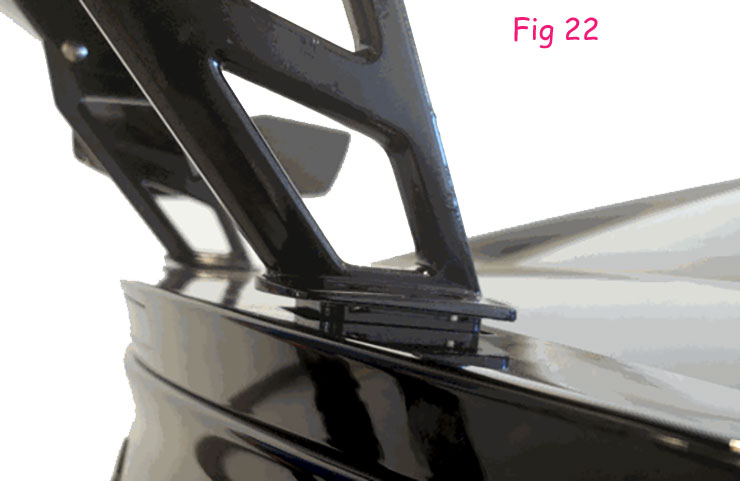

If the mounting piers are not positioned with the minimum 3 mm gap, the fascia paint may be damaged by the spoiler stanchions. Shown is the correct amount of clearance between the stanchions and the rear fascia. (Fig. 22)
