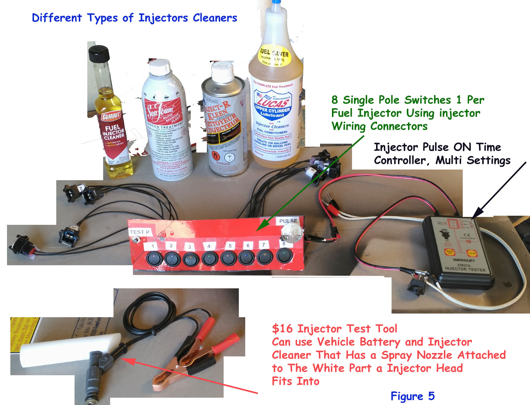

Figure 1 below shows the final design, with some parts I had lying around the total cost for this fuel system/ fuel injector test tool was under $75 There is injector cleaning products that depending on costs are supposed to do proper cleaning of fuel systems but most really cannot undo the degradation from the use of Ethanol
Below, Figure 5 shows four different fuel/injector products.
Some do very little and some are more costly and also are to do other cleaning as lubing the upper cylinders. Best case and does not have to be done in short time frame is take the fuel injectors out
A cheap way, not the best is like $16 for a tool that simply hooks up to the vehicle battery and 1 injector at a time is plugged into this tool ( as seen below) and you need a cleaning product that is a spray where the nozzle of it is pulled into the tool, connect the voltage and push the nozzle top. With the voltage to the injector allows it then to spray through the cleaner out the nozzle of injector.

2. Next test was to replace the pressurized air in the test tank with cleaning product. 3. To do this as seen below I built a system where I could test from 1 to 8 fuel injectors one at a time or multi ones concurrently. Your setup does not need all I did but you want a way to flush each injector with cleaner and be able to see
A. If the spray holes of injector are clean B. That the spray pattern on each look the same. C. Could go so far as to allow cleaner to spray through a injector into a small container that measures the amount cleaner sprayed in X amount of time. Such as if the injectors are rated to flow 55 CC a minute then allow your test to run that long and then see if the container measurement shows that amount of volume D. If not then assume the nozzle holes are partly plugged up and require more cleaning time
1. As mentioned the internal coil of injector was not designed to be on 100% of the time as that would overheat that coil 2. The engine management controller commands how long the injector will flow but in short milliseconds of time. As example at idle the PCM may command injectors to be on for 3 mS and then turn off. Maybe at part throttle command is 20 mS 3. This is called “Fuel Injector pulse width ON time” 4. So for our testing we needed to add a Pulse width controller that allows for a more real pulse on times. The one I used is set as reported below 5. Partly filled the pressure tank with a good know fuel injector cleaner
6. Did not want to spray/clean all 8 at the same time, I wanted control of each one 7. Did so by getting 8 single pole switches costing only $7 dollars for all 8 8. Bought 8 fuel injector wiring connectors that have shot pigtail wires and also installed a power switch, used a D/C power unit and a NODE you can buy that is a LED that would show the output pulses of the controller. A. With the cleaner in tank I pressurized it to around 40 PSI. B. Now I could turn on switch for 1 injector, watched the cleaner flow through it and looked at what the spray pattern looks liked. See figure 2 C. I then turned that switch off and repeated for the other 7 injectors while watching their spray patterns and assured there was still enough cleaner in tank and the pressure did not get too low.
