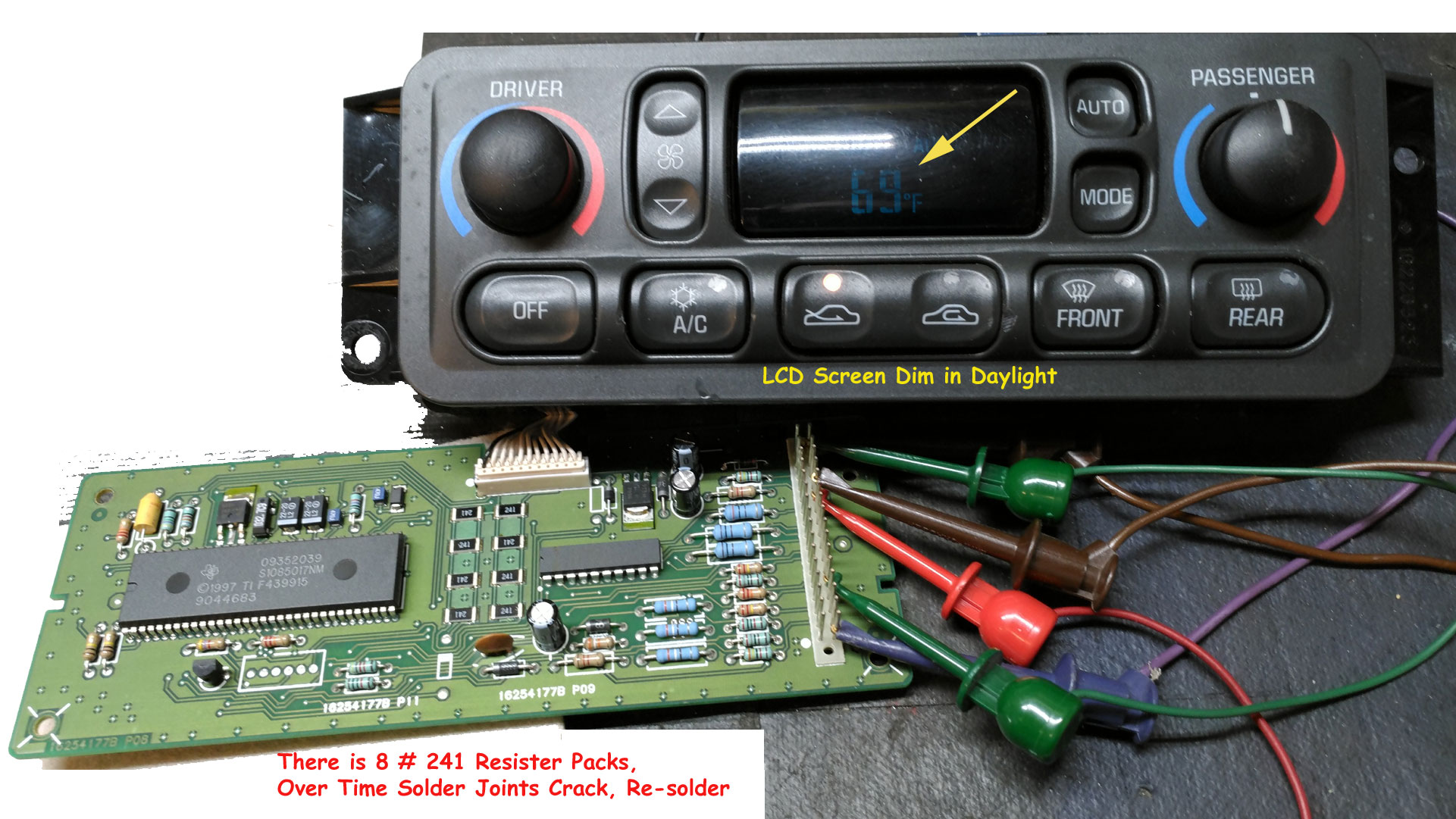

There is a common failure point for all C5 HVAC controller head in where the LCD screen the output goes dim and in sunlight cannot even be seen to make adjustments for what you want in HVAC

Here is an example of fixing this command failure point :
There is eight resistor packs, on top they say "241" Over time due to heat the soldering joints from them crack causing lower voltage to the LCD screen

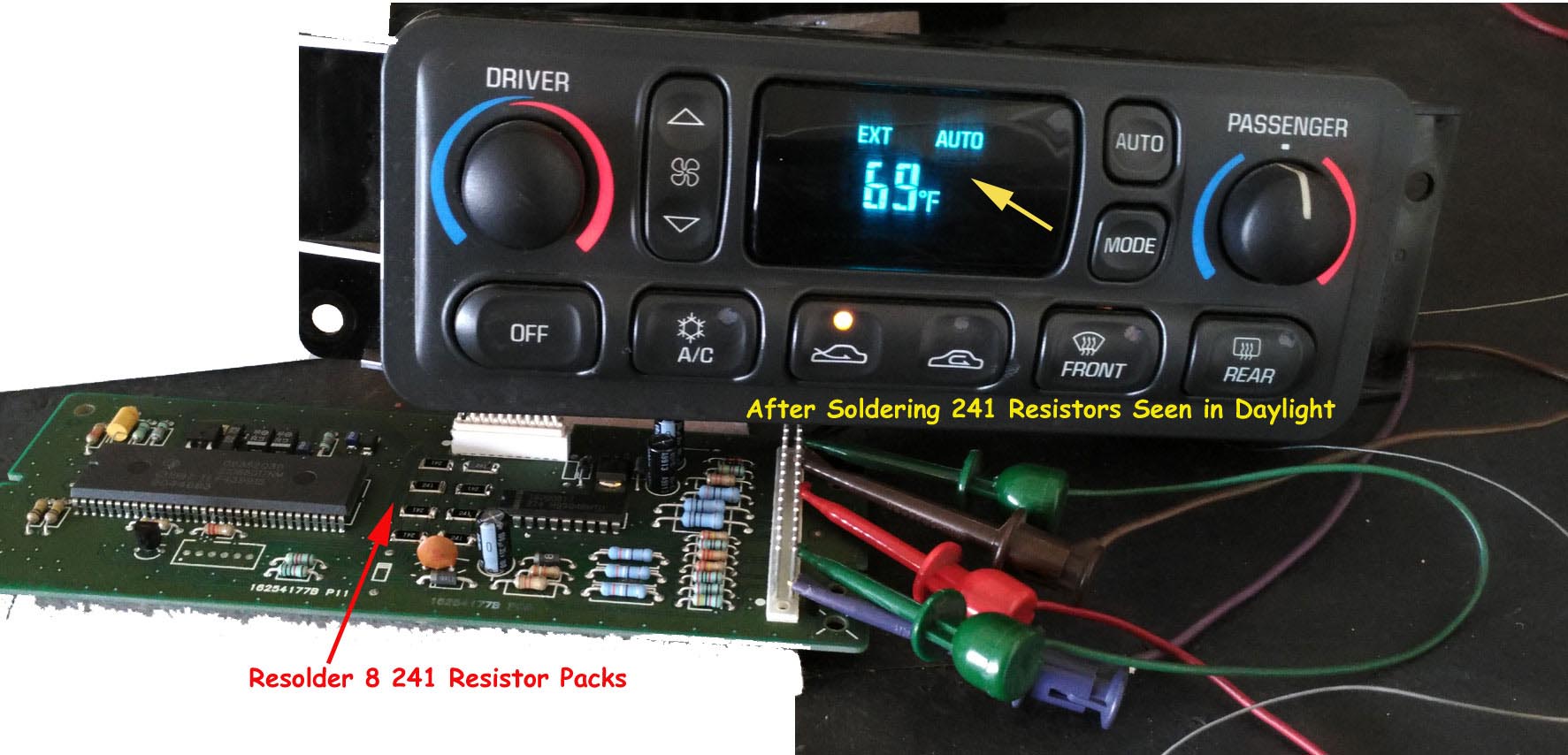

Take the HVAC unit out of the console, there is only 1 small mounting screen at each end. Disconnect the wiring harness from the unit Remove 4 small screws on the back side to crack open the rear and front cases. Lift up the rear daughter board out of that back case Turn over and look for eight resister packs labeled 241 Use a low wattage soldering iron with thin solder Re-solder both ends of each of the 8 resister packs, do not over heat them Best is re-solder just one end of each and then let them cool a few minutes and then re solder the other ends So that is 16 solder joint ends While unit is open lift the front daughter board by removing 4 small screws (1 per corner) and there is several LED as lights and the LCD screen and the lens for it and clean them Reverse the process in putting the HVAC unit back together and then reinstall back into the console Before installing center console turn Ign key to ACC and assure LCD now reads clearly
Cost is zero if you have small soldering iron and thin roll of solder, otherwise maybe spent $25 for them and use for other projects
Here is before and after re-soldering was done
NOTE : To show this I traced what each wiring pin was for and then temporarily hooked up voltages and ground to make the LCD screen viewable
