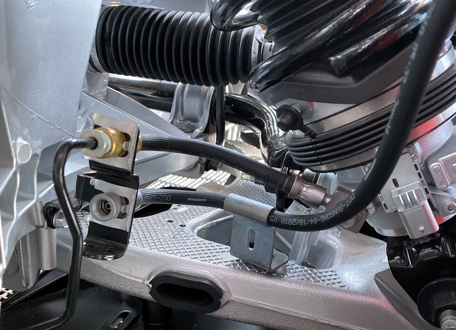

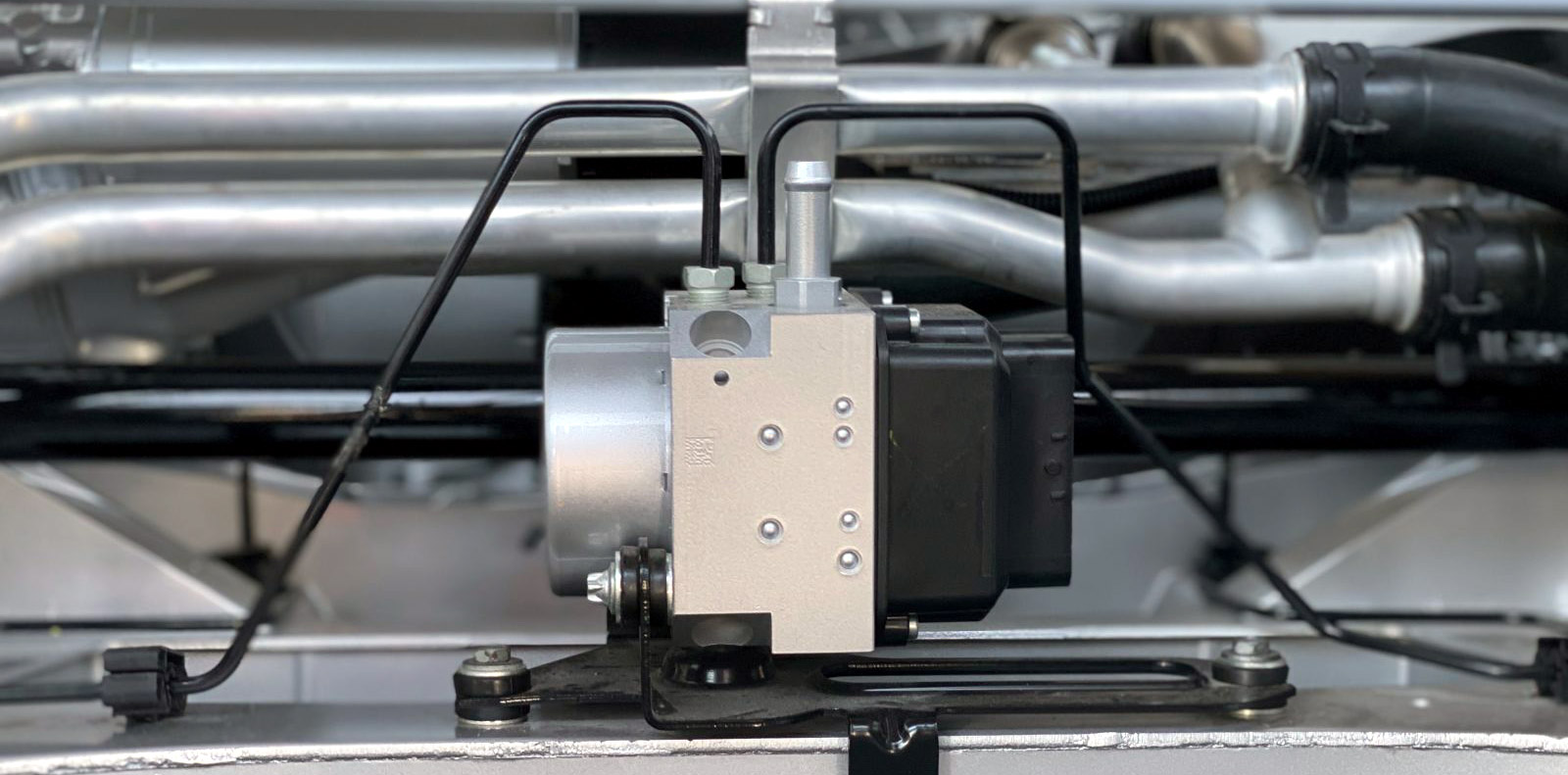

C8 will offer a hydraulic “front suspension lift,” option which Chevy says will raise the car’s ground clearance by 1.6 inches in just 2.8 seconds.
This, Chevy says in its press release, can protect the vehicle from speed bumps, potholes, steep grades, curbs, and other obstacles, and will function at up to 24 MPH.
There is a settable memory function, which Chevy says allows the driver to program as many as 1,000 locations so that the suspension automatically lifts the front of the car based on its GPS location.
That way, the driver doesn’t have to activate the lift via the button adjacent to the lift mechanism every time they arrive at the same speed bump on the road thanks to the functions of the GPS; the car will figure it out on its own.
As seen in a image you notice there is no adjuster to allow setting ride and corner weight of the coil-over spring frown
