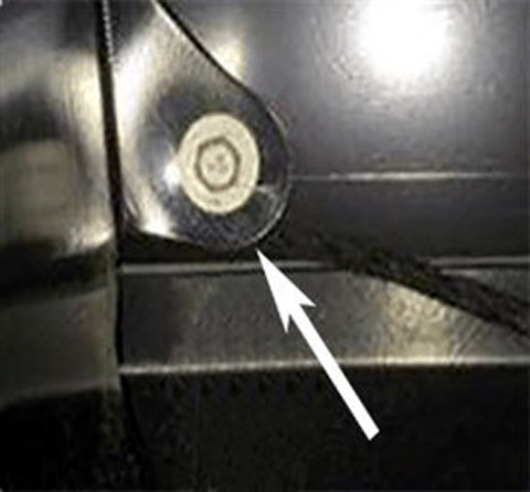

Example of a trapped wiring harness under the footrest mounting bracket.
