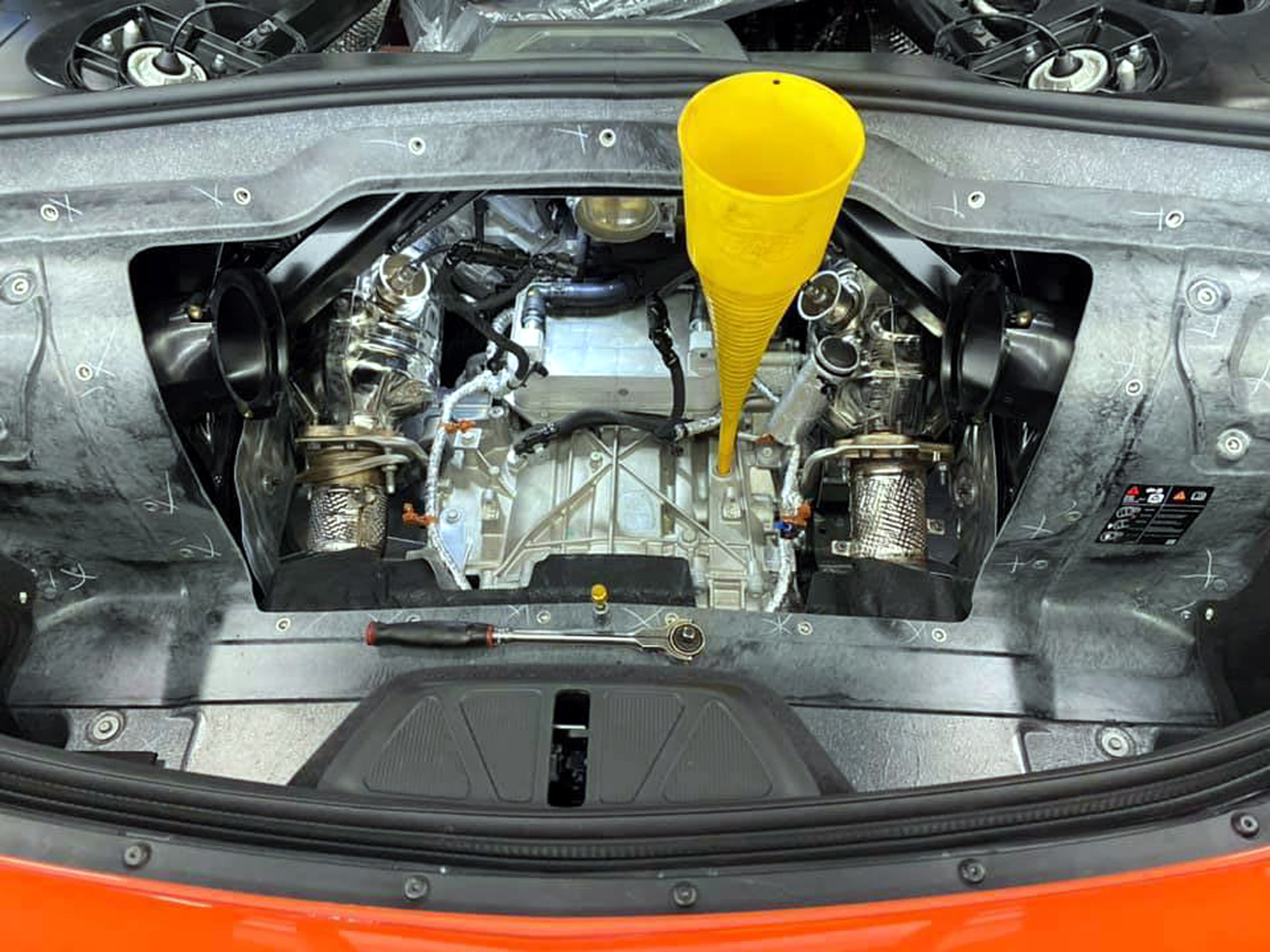

GM states for the 2020 Z51 Corvette to add 2 liters of DCT fluid for racing which then can be left in for normal street use
You have to take that back panel off in the storage area and then the airfilter can and air bridge to the throttlebody Fill plug is different in shape and has a alien head
Would be nice to use a pipe coupler and add some hose so that the fill hose is then attached to that panel cover so now any time replacing or adding the fluid could be done without taking anything apart
