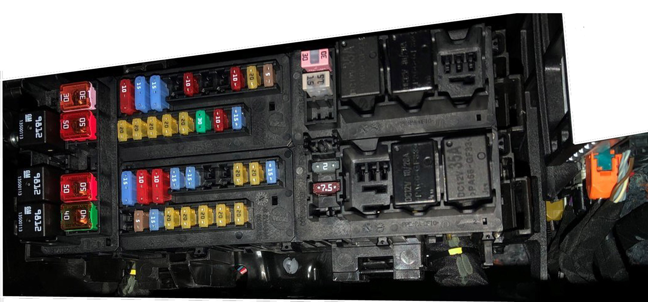

Instrument Panel Fuse Block
The instrument panel fuse block is behind the glove box.
The glove box can be accessed by unlatching the door damper and squeezing the pivot to release the damper ring.
Pull the glove box bin side walls in to release the door stops.
Then turn the door until the hinge hooks release from hinge pin.
To Access:
1. Open the top cover.
2. Remove the top cover by pushing inward on the latch.
3. Pull the cover upward.
To Install:
1. Insert the tabs on the back of the cover into the slots in the instrument panel.
2. Align the clip with the slots in the instrument panel.
3. Press the cover into place.
Fuses Usage
1 –
2 Front wiper
3 Cooling fan 1
4 –
5 Cooling fan 2
6 Front blower
7 Front lift/Automatic level control
8 Shifter interface board module
9 –
10 Display IP cluster/HVAC/Center stack Module
11 USB
12 –
13 –
14 Glove box
15 –
16 –
17 Remote function actuator
18 Front trunk release
19 Intelligent battery sensor
20 Exterior lighting module 1
21 Exterior lighting module 3
22 Exterior lighting module 4
23 Body control module 2
24 Exterior lighting module 6
25 Amplifier
26 Automatic occupant
sensing/Electric park
brake
27 Video processing module
28 Right headlamp
29 –
30 Sensing and diagnostic module/Automatic occupant sensing
31 Body control module 1
32 Column lock module
33 Data link connection/Wireless charging module
34 Telematics/Head up display
35 Horn
36 –
37 –
38 Front wash pump
39 Rear auxiliary power outlet
40 Performance data recorder/Center stack module
41 –
42 Theft deterrent
43 Left headlamp
44 Exterior lighting module 2
45 Power steering column module
46 Body control module 3
47 Exterior lighting module 5
48 Exterior lighting module 7
49 Body control module 4
50 Front auxiliary power outlet
51 –
52 Steering wheel control switch
53 Heated steering wheel
54 –
Relays Usage
1 –
2 Glove box relay
3 Horn relay
4 Front wash relay
5 Retained accessory power/Accessory relay
6 Front trunk release relay 1
7 –
8 –
9 Front trunk release relay 2
10 Wiper relay
