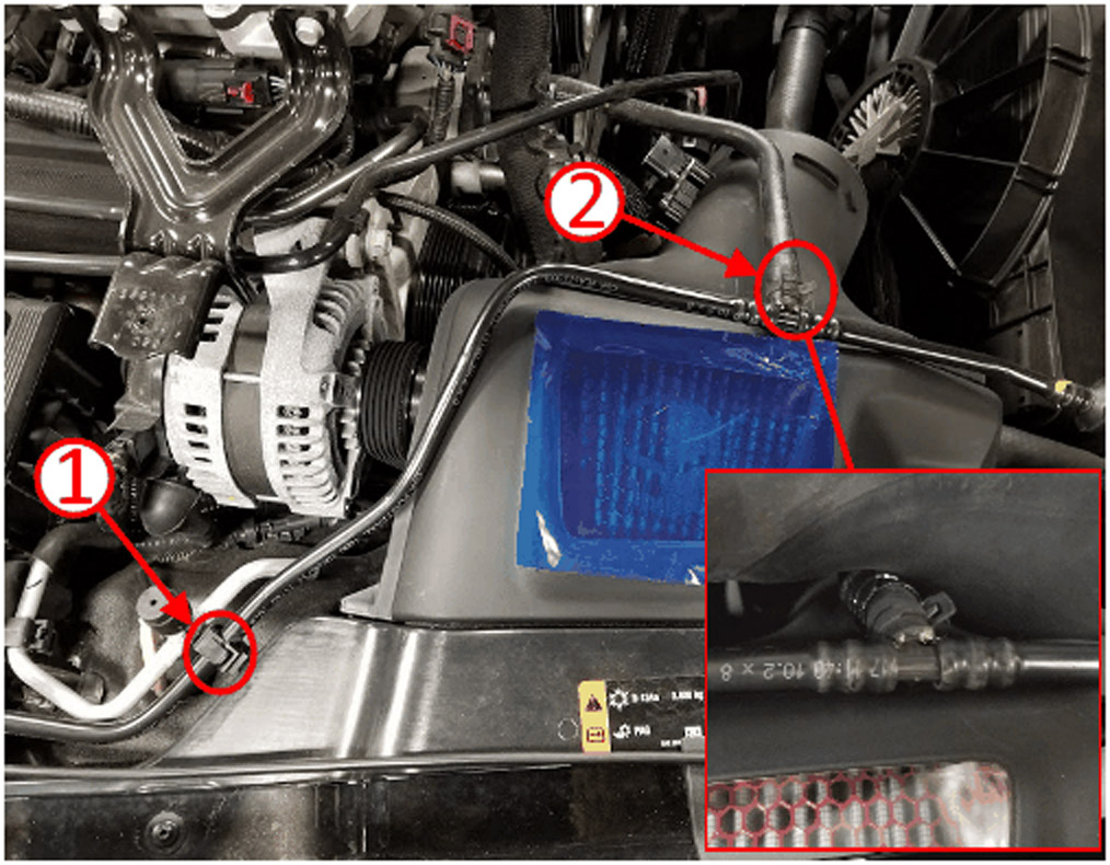

Remove and discard the retaining clip (1) that secures the coolant surge hose to the air box (2).
Make sure that the coolant hose is retained at the original fender clip location (1).
Rotate the coolant hose clamp (2) about 90-degrees forward and check clearance.
