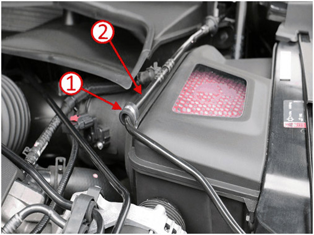

Remove and discard the retaining clip that secures the coolant surge hose to the air box. Ensure that the coolant hose is retained at the original fender clip location. If this clip is not present, it must be ordered and installed.
Rotate the coolant hose clamp approximately 90-degrees forward and check clearance to the hood extractor and MAF tube. Adjust as necessary.
Remove and discard the retaining clip (1) that secures the coolant surge hose to the air box (2).
Make sure that the coolant hose is retained at the original fender clip location (1).
Rotate the coolant hose clamp (2) about 90-degrees forward and check clearance.
