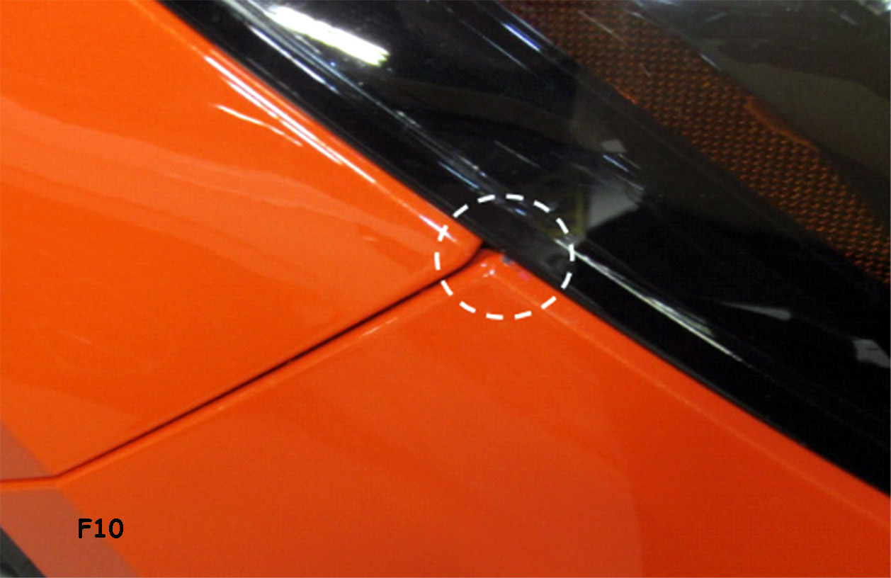

Some 2020 Corvettes may have a small paint chip in the front fascia below the headlamp on one or both sides of the vehicle. (Fig. 10) The paint chip may be caused by a miss positioned fender-to-fascia gap joint.

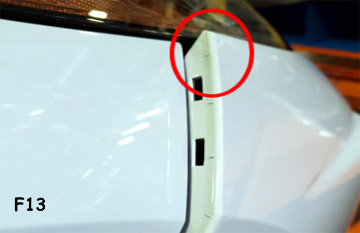

After adjusting the fender inboard, the headlamp lens (Fig. 12, #1) will be proud of the fender (Fig. 12, #2) and the fascia tip will install below the headlamp lens. (Fig. 13)
