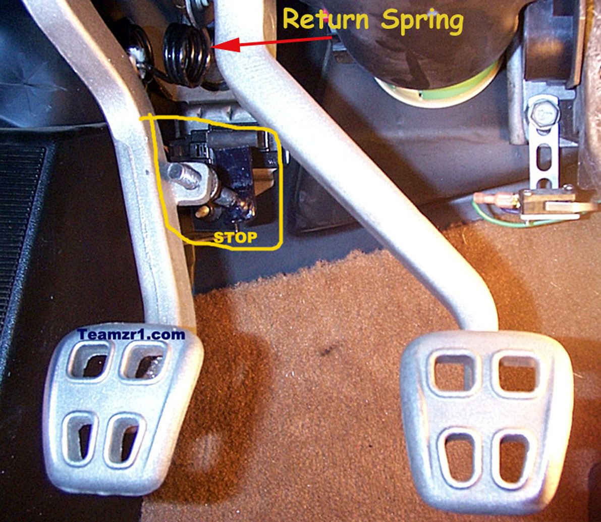

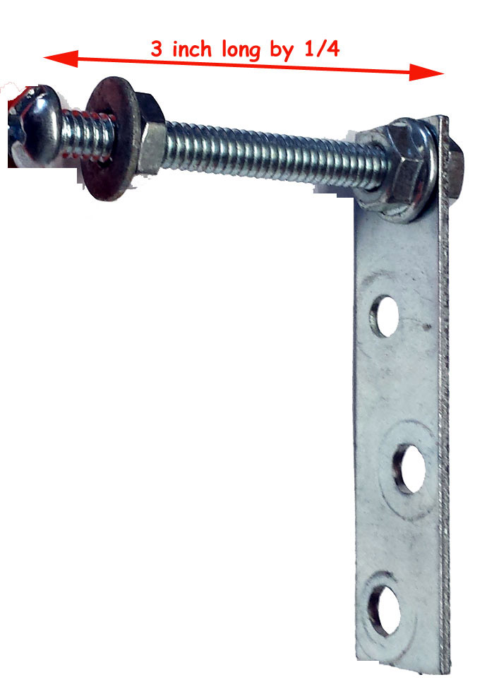

I cannot recall the exact length since that was back in like 2006 when I made that clutch pedal stop for my 1999 Mallett 435 C5
I did use a bolt as shown below, it's length and then kept adjusting the length till it worked they way I wanted clutch release speed.
Looks like in the image I adjusted that bolt length down about 1/4 to 1/2 inch
You might also want to replace the clutch return spring due to it's age and also consider using one for a C6
Refer to :
Clutch Return Spring C5/C6
Also as i have done was to take a straight spring, mounted it to upper pedal arm and then to support under dash at a angle
That really helped at high RPM shifts where clutch pedal does not want to return when lifting off pedal
Sine I did that I have no problems doing 6,900 RPMs shift's like in 1st to 4th gear at drag races
