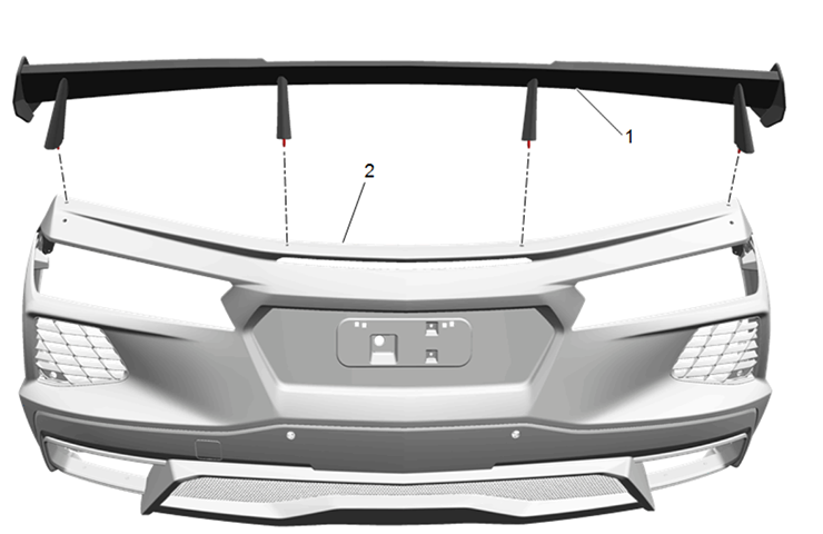

If the Z51 spoiler is to be replaced with the high wing accessory spoiler, there may be some concern about applying heat to soften the two-way tape retaining the spoiler without damaging the rear fascia paint.

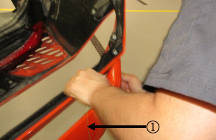

To remove the Z51 rear spoiler, it’s recommended to use 50 lb. test monofilament fishing line.
Position the line (Fig. 16, #1) between the spoiler and fascia and, with a sawing motion, move the fishing line through the two-way tape to remove the spoiler. Using the fishing line method will eliminate any possibility of damage to the painted fascia surface.
Do not use a heat gun, or attempt to pry the spoiler off the fascia with a plastic, metal or wood trim removal tool, in order to loosen the adhesive tape.
The installation instructions for Rear End Spoiler Package Installation (Fig. 17) in the Accessories Manual in the Service Information have been updated to eliminate the use of a heat gun to soften the two-way tape. Follow the updated installation instructions and do not use a heat gun during the removal process.
