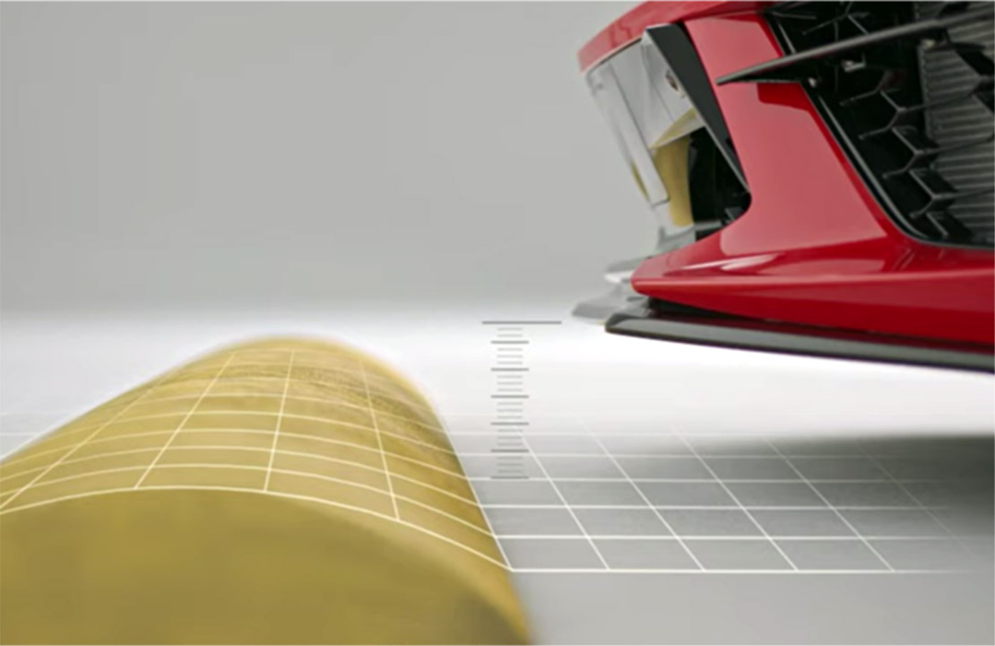

Front Leveling System
The Front Ride Height Control (FRHC) system is designed to raise the front of the vehicle out of trim (nominal unraised position of the suspension) position during low-speed driving scenarios in order to help avoid objects on the ground and reduce the potential for damage to the front spoiler. (Fig. 14)
The increased ground clearance can help to navigate speed bumps and steep driveways as well as to clear frame contact hoists or floor jacks during a service event.
The FRHC system consists of front shock absorbers with built in two-position lift actuators, hoses, lines, hydraulic fluid reservoir and an electro-hydraulic control unit. The benefit of the system is to provide increased ground clearance to navigate speed bumps, steep driveways or service events to clear drive on hoists, frame contact hoists or floor jacks.
