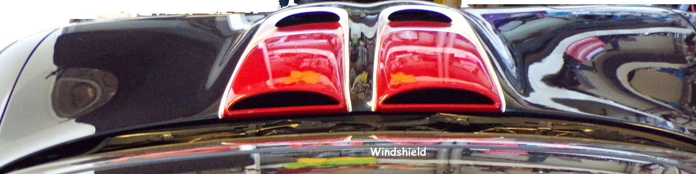

It has a well vented hood as shown below that forces colder outside air in, flows in engine bay and then exit scoops that the air flowing above hood extracts the hotter bay temps put

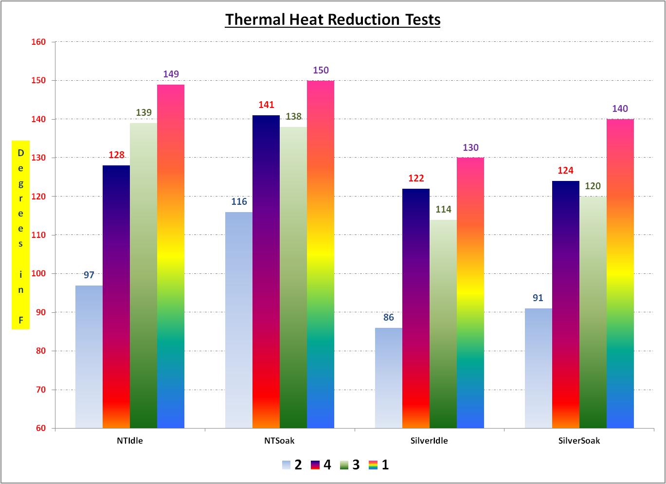

1. With no thermal reflection product is used
2. Reflection reduction using a silver based product

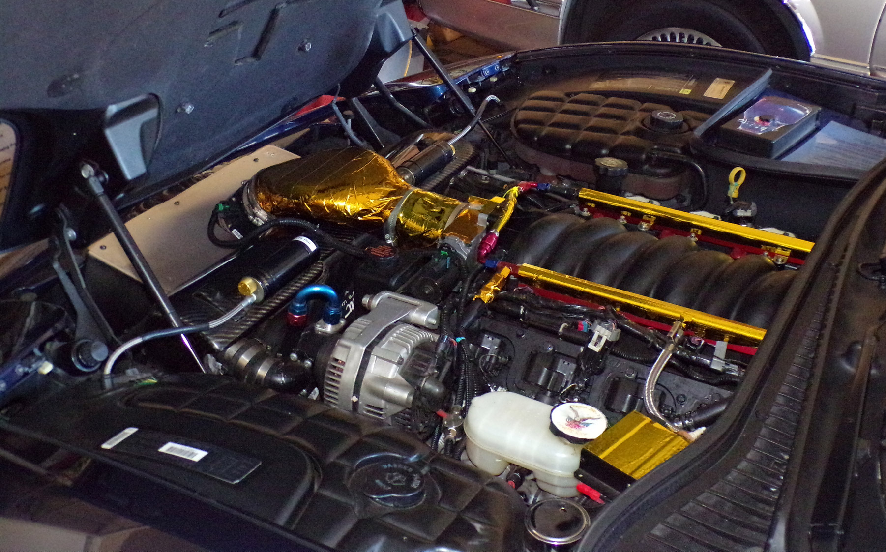

3. Instead using a gold based product
At this time results are showing no thermal and using silver product

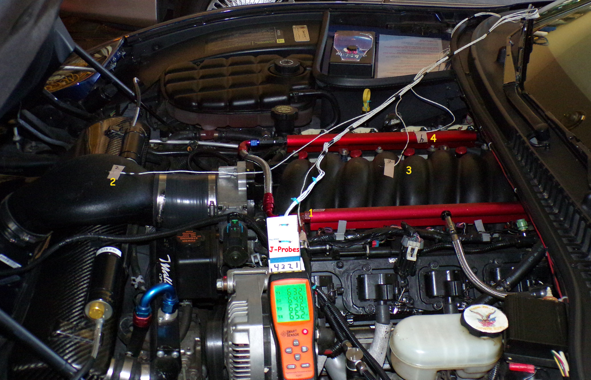

J-Probe locations
1. Fuel Pressure sender off fuel rail
2. Air bridge from aircleaner
3. Center of intake manifold
4. Right fuel rail
Weather was 76 deg and coolant temps stayed around 188 deg
1. After C5 was driven in 76 deg weather and coolant temps around 186 F degrees
2. Then let idle for 6 minutes and then recording temps via the four J-Probes concurrently at the points shown below
3. Then after engine is turned OFF and letting heat soak for 6 minutes with hood shut and then recording the probes temp readings
Will be installing a gold based reflection reduction product and repeating the tests
