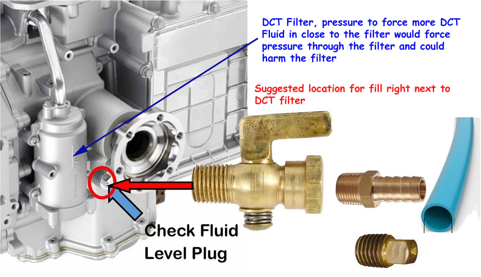

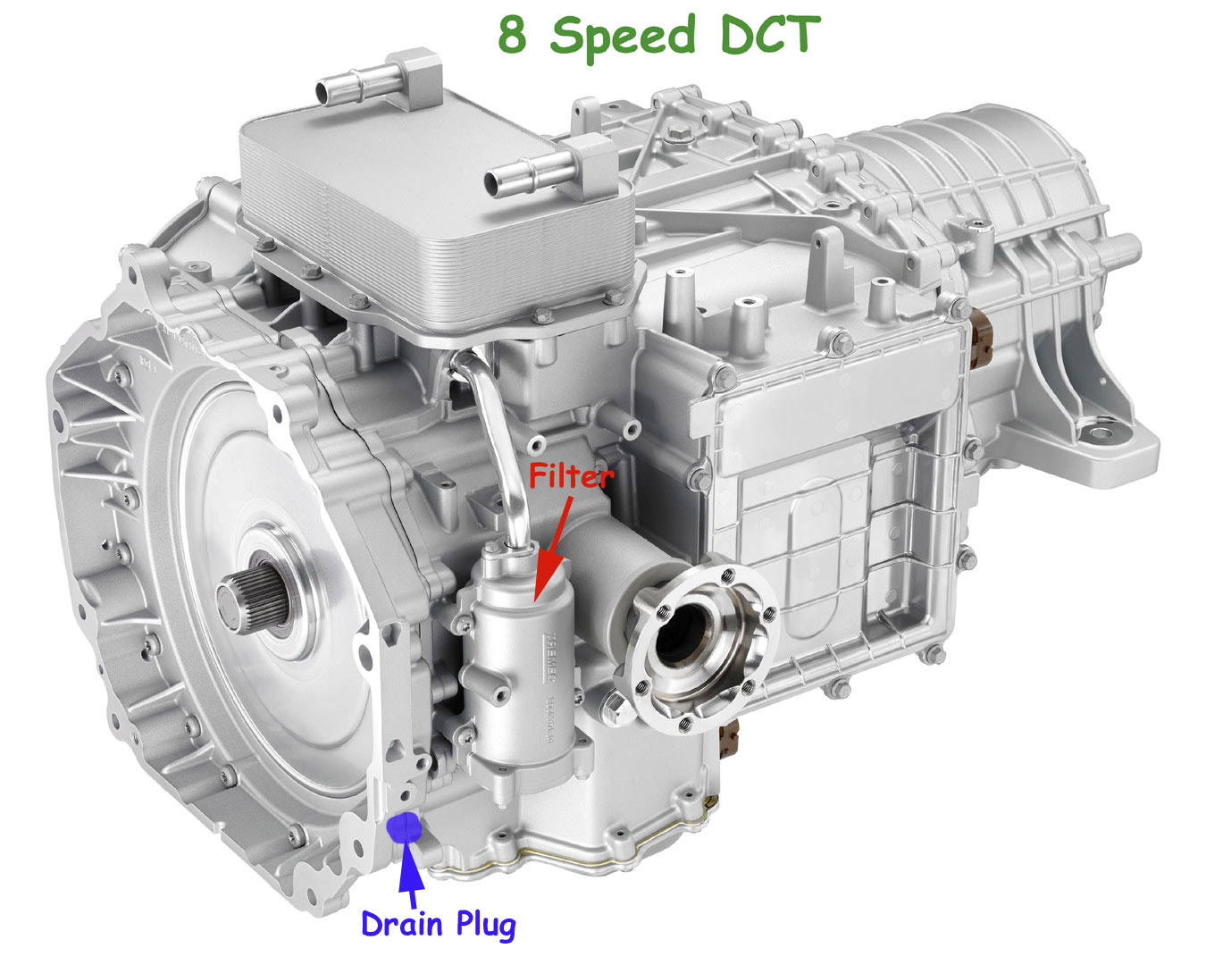

#4969 - 12/10/20 08:21 PM How Not to Fill/Drain C8's DCT
Posts: 6,036
Posts: 6,036
Cyberspace Corvette forums breeds dummies at times and right now it has convinced C8 owners in flushing, draining and filling the DCT fluid
by replacing the DCT drain plug at bottom of DCT with a shutoff valve replacing the plug and adding a hose to it
So problem is to use that for filling the DCT fluid has to be put in a container that air-pressure can be added and then back force the fluid into the DCT
Dummies did not think as the DCT has an expensive fluid filter as seen below and it will be directly in the path of that fluid under pressure forced
to back flush the filter and push the trapped crap in filter back into the tranny.
Also depending on how much air-pressure they use could damage the paper filter and would not be known the DCT is then functioning without
a functional filter and worse if made of paper could rip up and carried throughout the fluid around the DCT
Filter at this time is not cheap and not easy to buy one for around $200.
Also a good chance if a cheap shutoff valve is used that the handle for open/close of valve pops open and drains all the fluid out without owner even knowing
it until the DCT craps out.
Time instead should be to take the engine aircleaner setup out one time and add a hose to a coupler to replace the top fill plug with a fill hose connected to that
and have hose long engine to end within engine bay so in future simply take a hose cap off, add a funnel and fill without having the jack the C8 up

I have seen images on the 2 quart fill of C8 DCT where suggested is using either the fill or drain plugs to inject 2 quarts of DCT fluid into the DCT
Really makes no difference if the fill one is used as seen is right by the DCT filter and doing this using air pressure can cause that pressure
through the DCT filter and I doubt it can handle pressure like that
Imagine a mistake and using 125 PSI for this type of fill process
Also have seen that only the whole left side of C8 be jacked up at a high angle
The car was not designed for that and could cause a weight shift/load and break something
I am first hand in that being doing as having driven 1,500 plus to race at ORR out of Texas
I had the local Chevy dealer then replace the engine oil
I then went to practice, was running over 160 MPH, went to slow down and C4 ZR-1 about flipped over and only decades of racing was I able to get car stopped
Got out of car to find Mobile I engine oil covering everything from front all the way to back end, including both left brakes soaked in oil and the tires sick
Turns out the damn tech at dealer did the same, instead of proper jacking of car they only jacked up the left side so car was titled up high causing shift/.stress
which broke a weld of external oil cooler
I still say it is a one time job to add a fill hose to top of DCT so hose then is placed where it can be reached easy in future fills,
car on the ground and no need of any compressed air being used.
One image example on how close the DCT filter is to where the OP suggests the fill be done:
