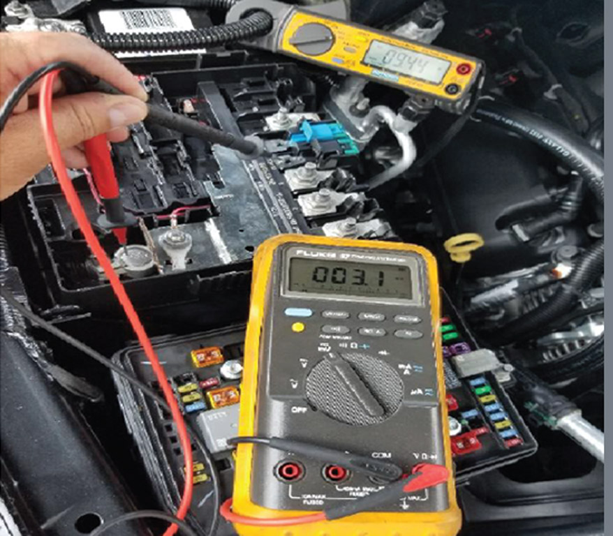

Several tables have been added in SI that list the milliAmps (mA) value across the fuses in a fuse block. Use a DMM set to mV scale to check the voltage drop between the battery positive post and each leg of the battery junction block (if equipped) to determine which fuse block contains the draw. (Fig. 1)
Once the fuse block feed with the highest draw has been identified, go to that fuse block and check voltage drop across fuses, excluding J-case type fuses, one at a time. For three-bladed fuses, the center of the fuse is the supply voltage for both sides of the fuse. Compare the reading to the corresponding fuse in the table. If voltage drop is found, refer to the Power Distribution Schematics to diagnose exactly which circuit of a suspected system is causing the high parasitic drain.
