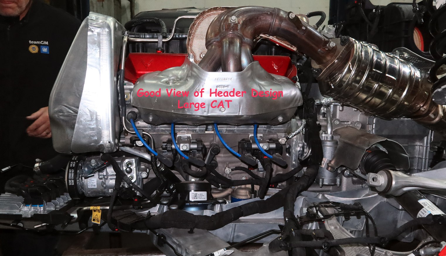

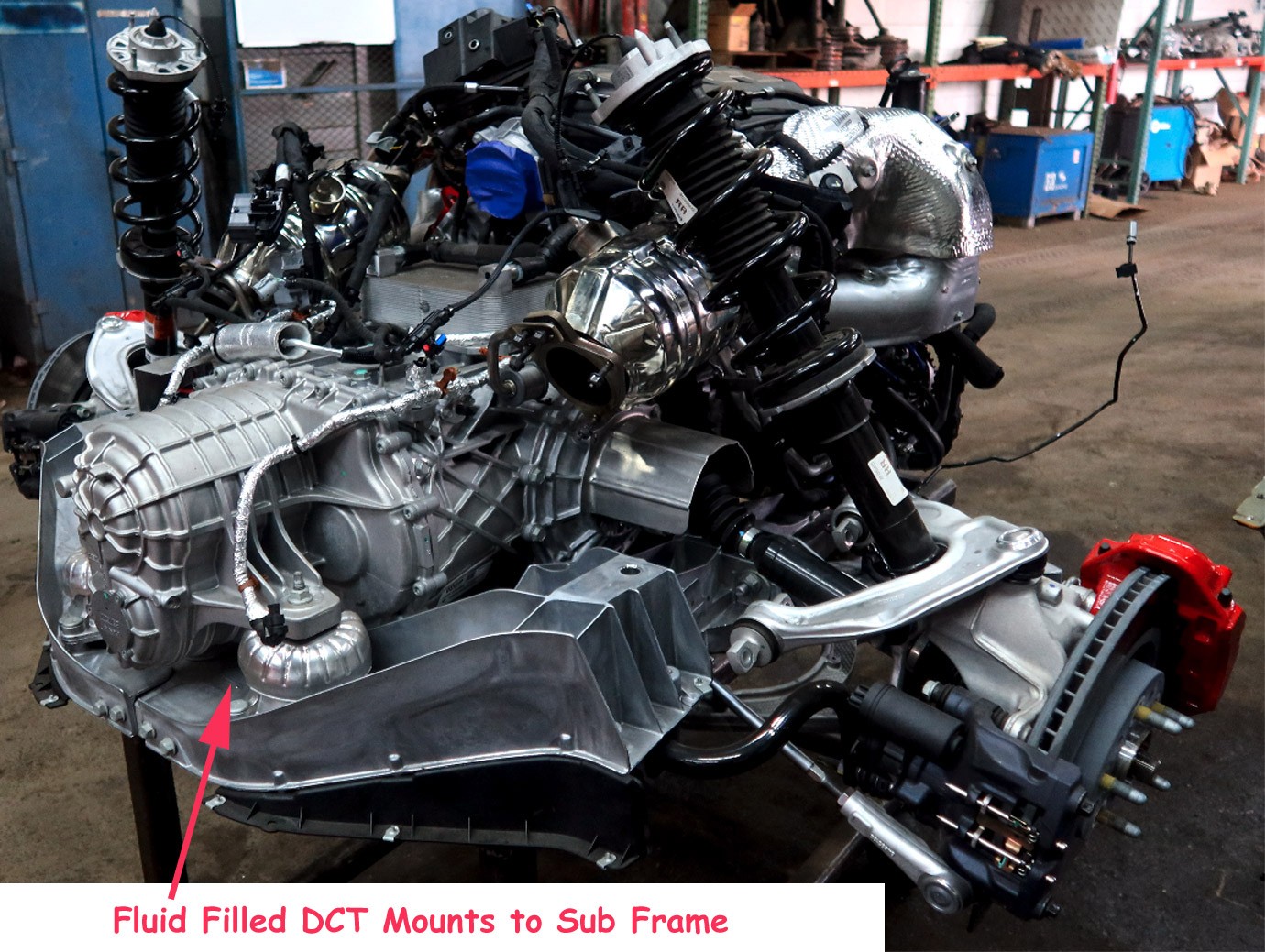

Take a closer look of the design of LT2 and DCT
Far more complex then in past Corvette engines

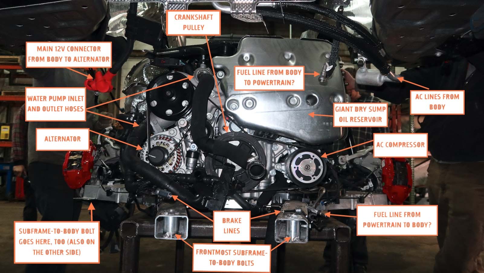

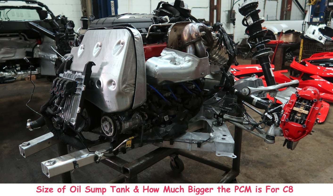

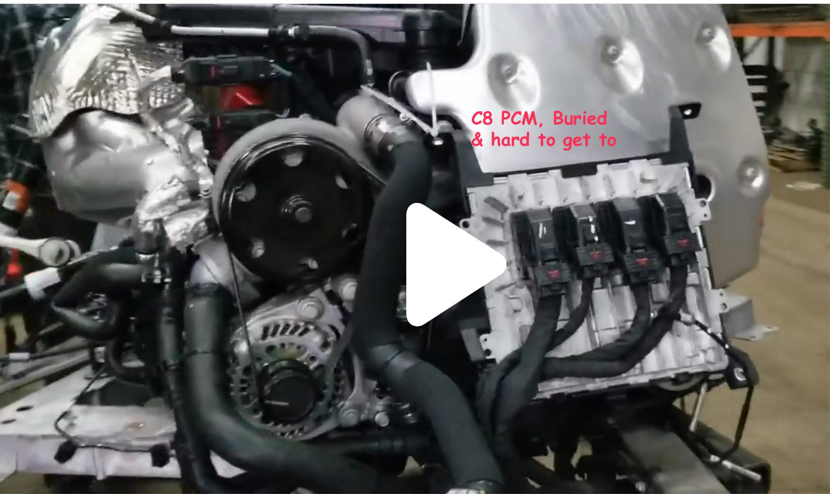

Be hell getting to front of engine jammed up by the bulkhead, worse for like crank pulley and PCM is now much larger and
buried :-(
