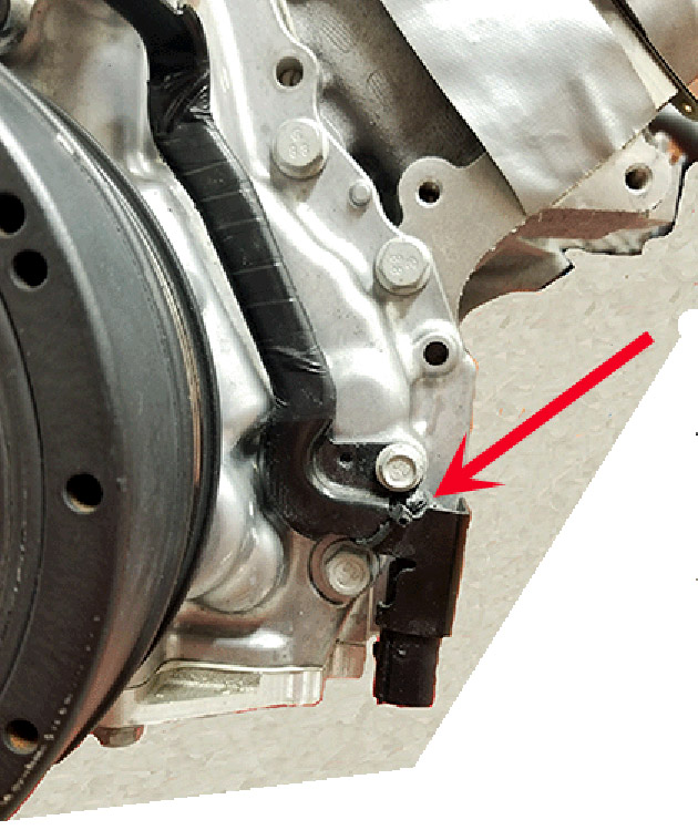

The cause is a possible wiring jumper harness chaffed at the bolt at the X154 connector on the lower left (driver) side of the engine front cover. Inspect for the wiring harness being chaffed or pinched under the bracket. Before installing a new jumper harness, be sure to inspect the harness.
Inspect for the wiring harness pinched or chaffed under the mounting bracket. Fig 1

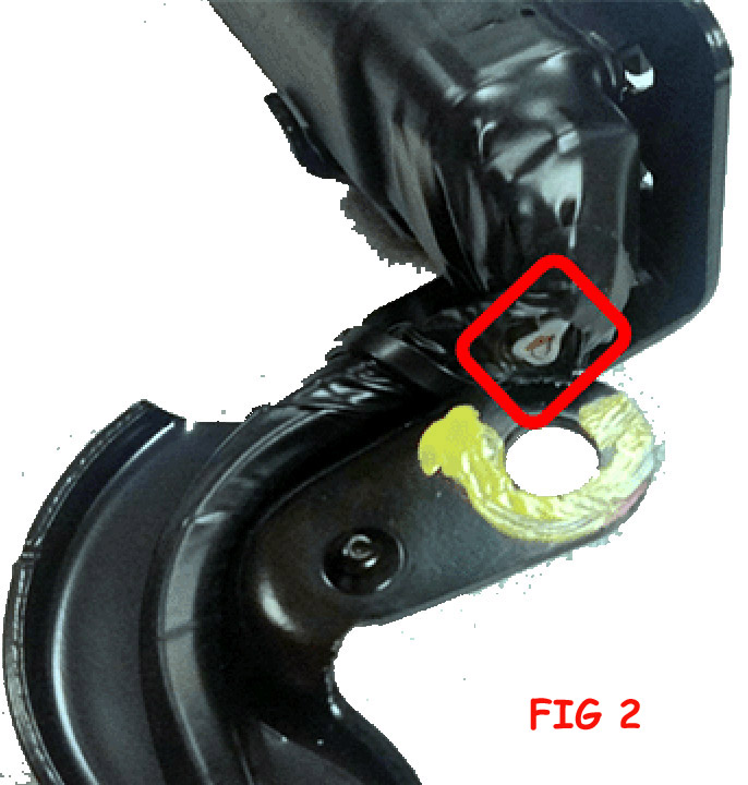

Example of chafed wire under the bracket. Fig 2

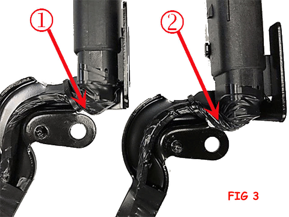

1) Example of a good harness.
Note that it clears the bracket’s mounting eyelet. 2) This harness is suspect and may get pinched under the bracket when installed.
If the harness is not pinched or otherwise damaged but is very close to the bracket ear, adjust as needed to ensure that no damage will occur. Fig 3
