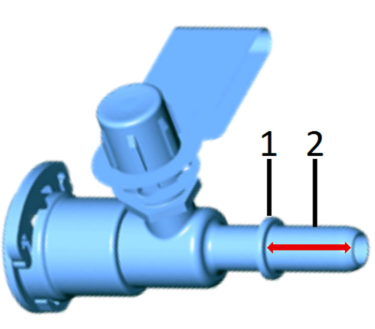

If the CH-52519 EVAP tool is not modified, or a commercially available low profile fuel line disconnect tool is not sourced to be used, it will result in the CH-52519 EVAP tool not being able to be removed from the EVAP purge line. The rib located on the CH-52519 EVAP tool needs to be modified in order for the tool to be removed from the purge line.
To modify the CH-52519 EVAP tool, partially file down the rib (Fig. 17, #1) on the tool. File the rib evenly and do not file the rib flush as damage to the sealing surface may occur. Leave a small amount of rib material on tool without damaging the sealing surface (Fig. 17, #2). This modification should not have any effect on how the tool works with other vehicles.
Use care to not damage, cut, or scratch the tool when filing the rib. Any damage to the tool will result in the tool not sealing properly when installed.

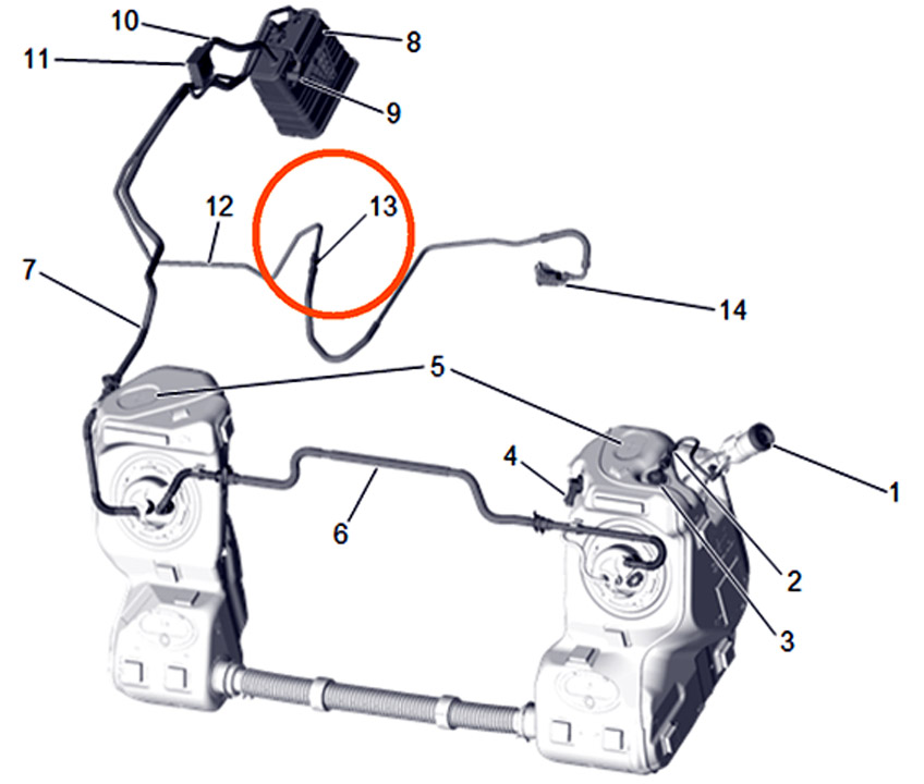

Refer to the Document I.D. 5757934 in the Service Information for more information about the installation location for the CH-52519 EVAP tool. (Fig. 18)
