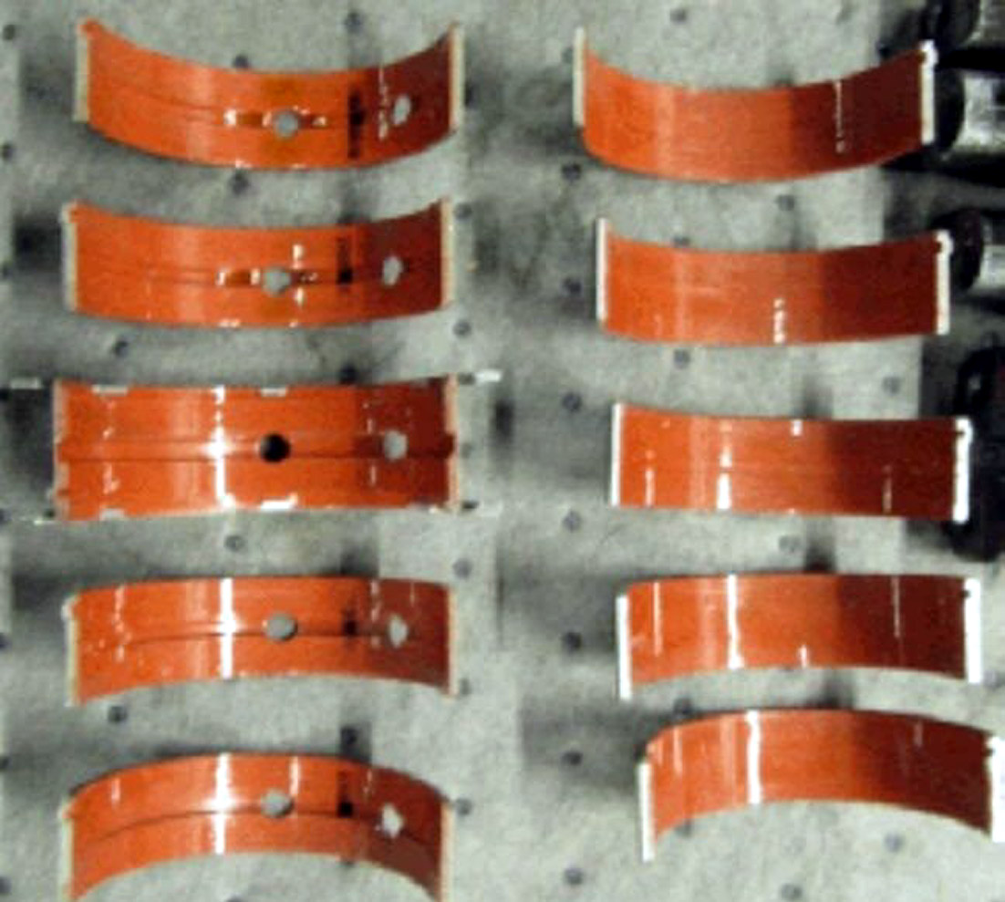

The thrust bearing is located at the middle (#3) main bearing position. In this photo, the thrust bearing is seen at the left, center (third from top).
The #3 main bearing upper half, which is installed to the block, features the thrust faces. Inspect the thrust faces for wear.
