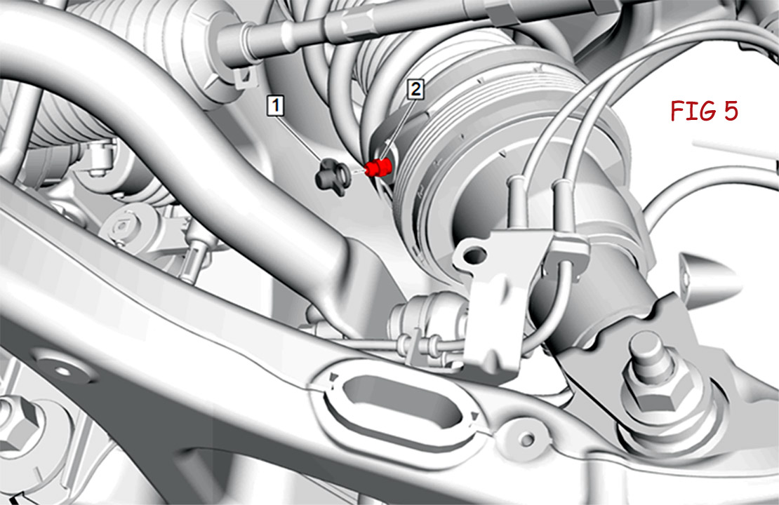

Next, raise and lower the front suspension system through 10 complete cycles. If the DTCs reset, perform the Front Hydraulic Suspension Bleed procedure and reevaluate the concern. Any time the front hydraulic suspension system is opened, it’s necessary to bleed the system at the front hydraulic suspension actuator bleeder valve (Fig. 5) using the CH-29532-A Pressure Brake Bleeder and CH-44894-A Brake Bleeder Adapter. Be sure to perform the bleed procedure before replacing any components.

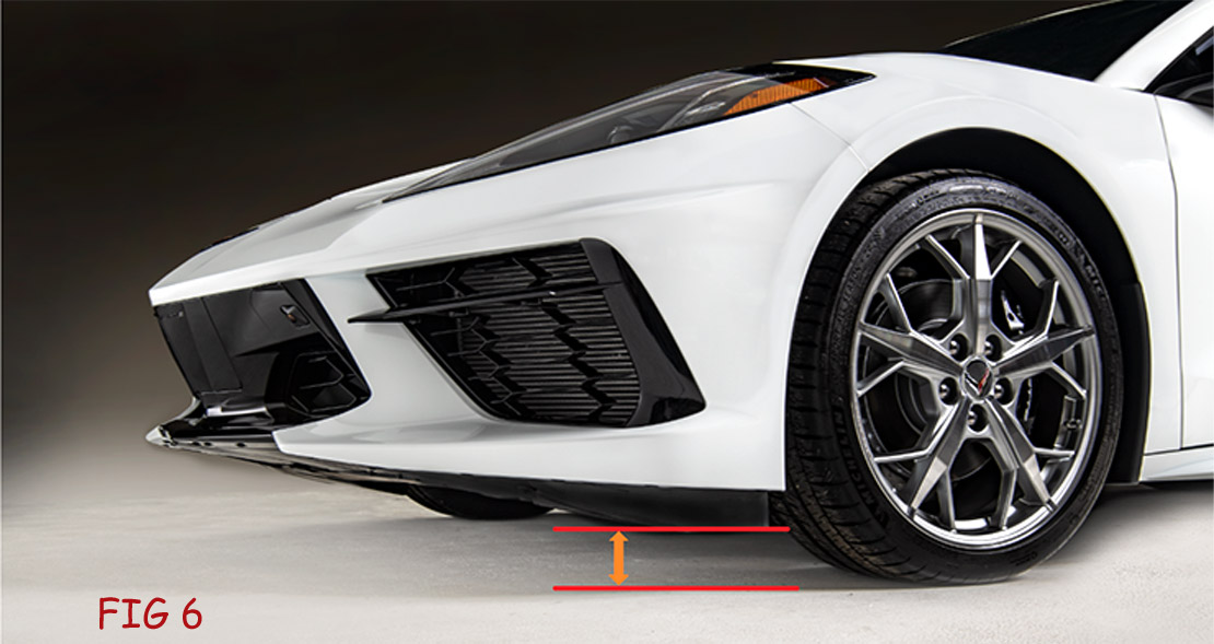

After bleeding the system, verify proper system operation by measuring the distance between the floor and the lower portion of the vehicle’s front fascia. A correctly operating vehicle should reach a front fascia height of at least 35 mm within four seconds of pump operation
