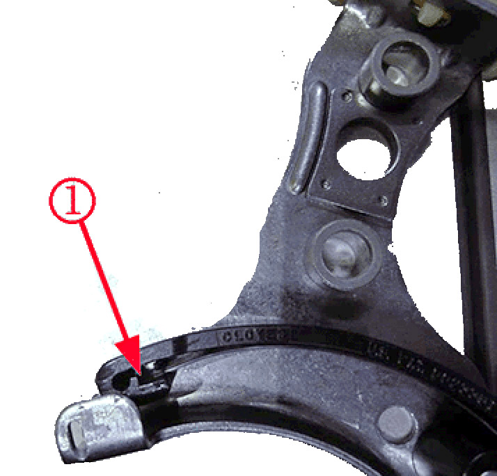

If the vehicle sets code P06DD, this indicates no or low oil pressure. The oil control valve may be stuck off, commanding high oil pressure (98 psi) and/or the oil pump face may be damaged.
The tensioner spring in the timing chain guide may be “short,” and not fully seating into the guide pivot end.
Cycling the oil pump control valve will not cause changes in oil pump response. Replace the timing chain tensioner guide.
