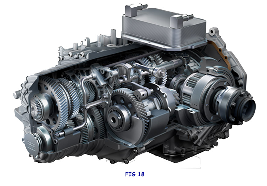

A Service Transmission message or a Service Engine Soon message may be displayed on the Driver Information Center of some 2020-2021 Corvettes equipped with the DCT TR9080 transmission (RPO M1L) (Fig. 18) along with DTCs P2838 (Shift Fork 2 Position Sensor Circuit Low), P2839 (Shift Fork 2 Position Sensor Circuit High) or P283A (Shift Fork 2 Position Sensor Circuit Intermittent).
