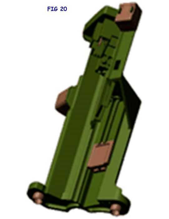

The Odd Sensor Module (Fig. 20) is located in the shift fork assembly and contains the transmission input shaft speed sensor odd gears and the shift fork 1 position sensor and shift fork 2 position sensor. The TCM uses the output speed sensor signal along with the even and odd input shaft speed sensor signals to determine transmission line pressure, shift patterns, and the correct gear ratio.
