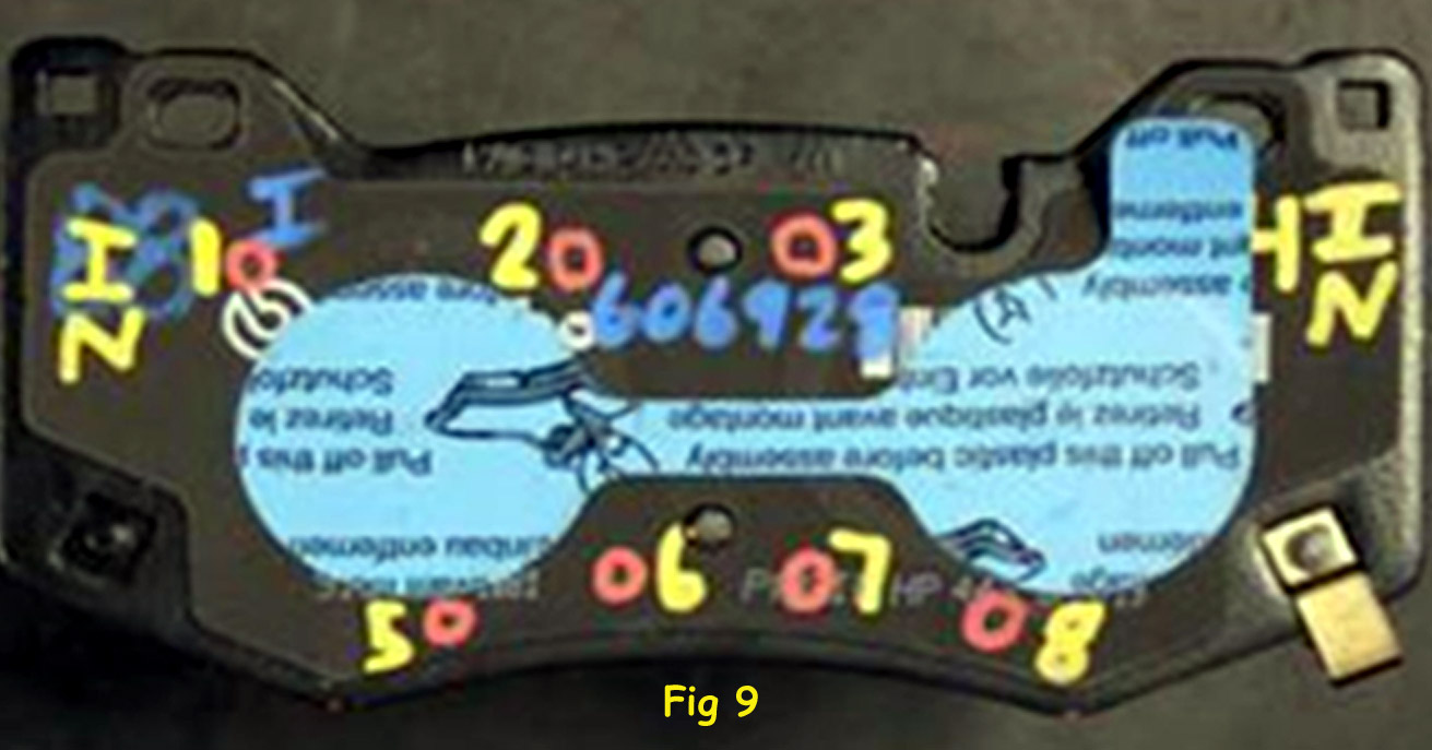

When removing the front brake pads on some Z51-equipped vehicles, a piece of double-sided tape that secures the front brake pads firmly to the caliper pistons may be noticed. As shown, the blue area is the peel-and-stick double-sided tape. (Fig. 9)

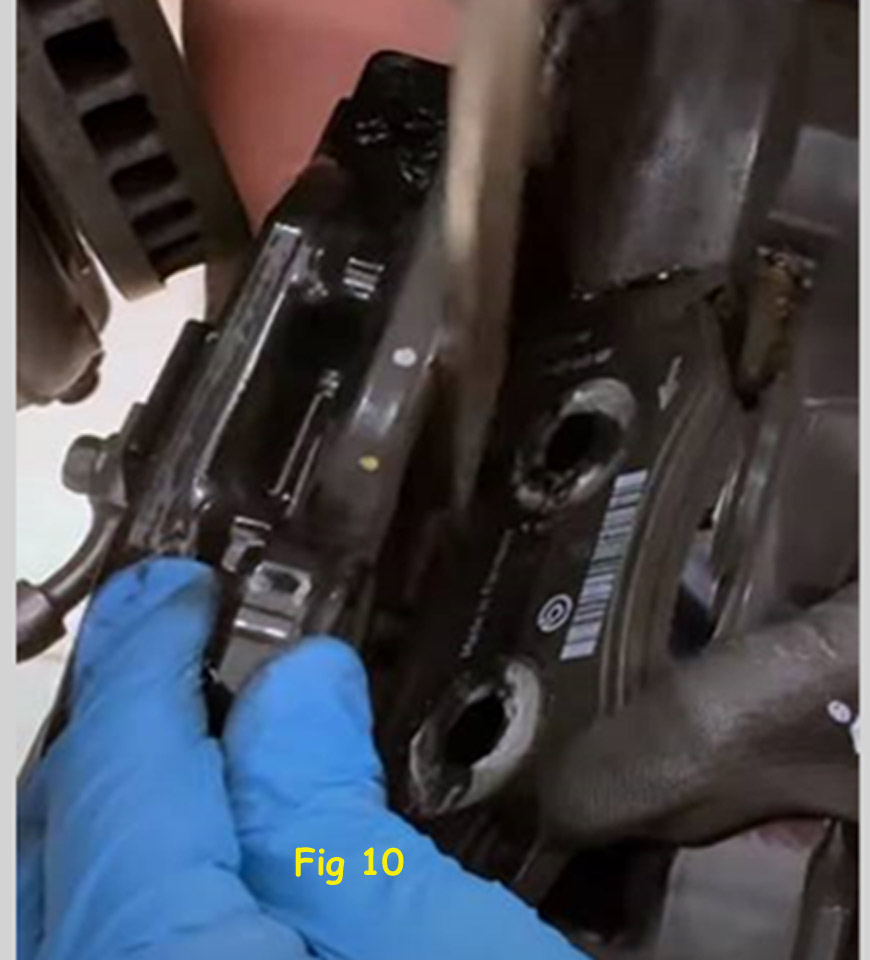

To apply the copper paste correctly, the pads must be removed from the calipers. (Fig. 10) Note that for the pads to be removed from the front calipers, the calipers must be removed from the front knuckles. Remove as much of the remaining tape residue as possible before applying the paste as directed in the bulletin.
Once the copper paste has been applied to the front brake pads, reinstall them into the calipers. It’s not necessary to replace the front brake pads during this service because of the double-sided tape.
