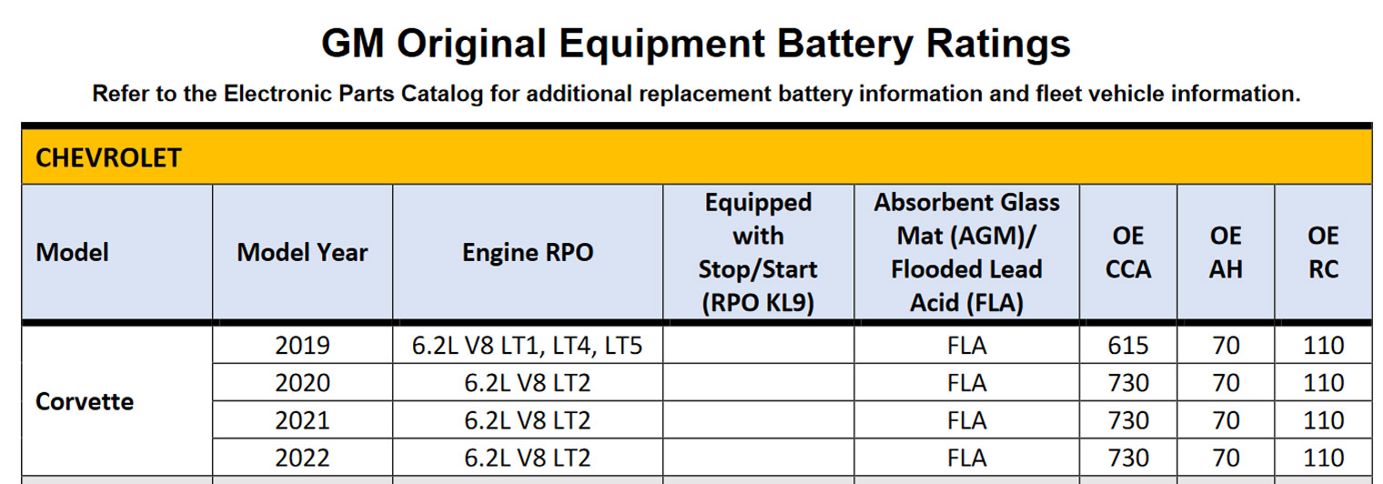

An updated Original Equipment (OE) Battery Ratings chart, with added specs for 2022 models, is now available for use when testing batteries using the EL-50313 GR8 Battery Tester/Charger & EL-52800 Diagnostic Charge Battery Station (DCBS). The chart includes cold cranking amperage (CCA), amp hours (AH) and reserve capacity (RC) ratings as well as battery type specifications for the 2019-2022 model years
Correct battery CCA ratings and battery type are critical for proper test results. Access to the battery label, which contains the OE CCA rating and battery type, may be difficult on some models, depending on the battery location. Using the updated chart can help when setting up a proper battery test for the OE battery. If the original battery in the vehicle has been replaced, the OE information in the battery chart may not match the battery currently installed in the vehicle.
