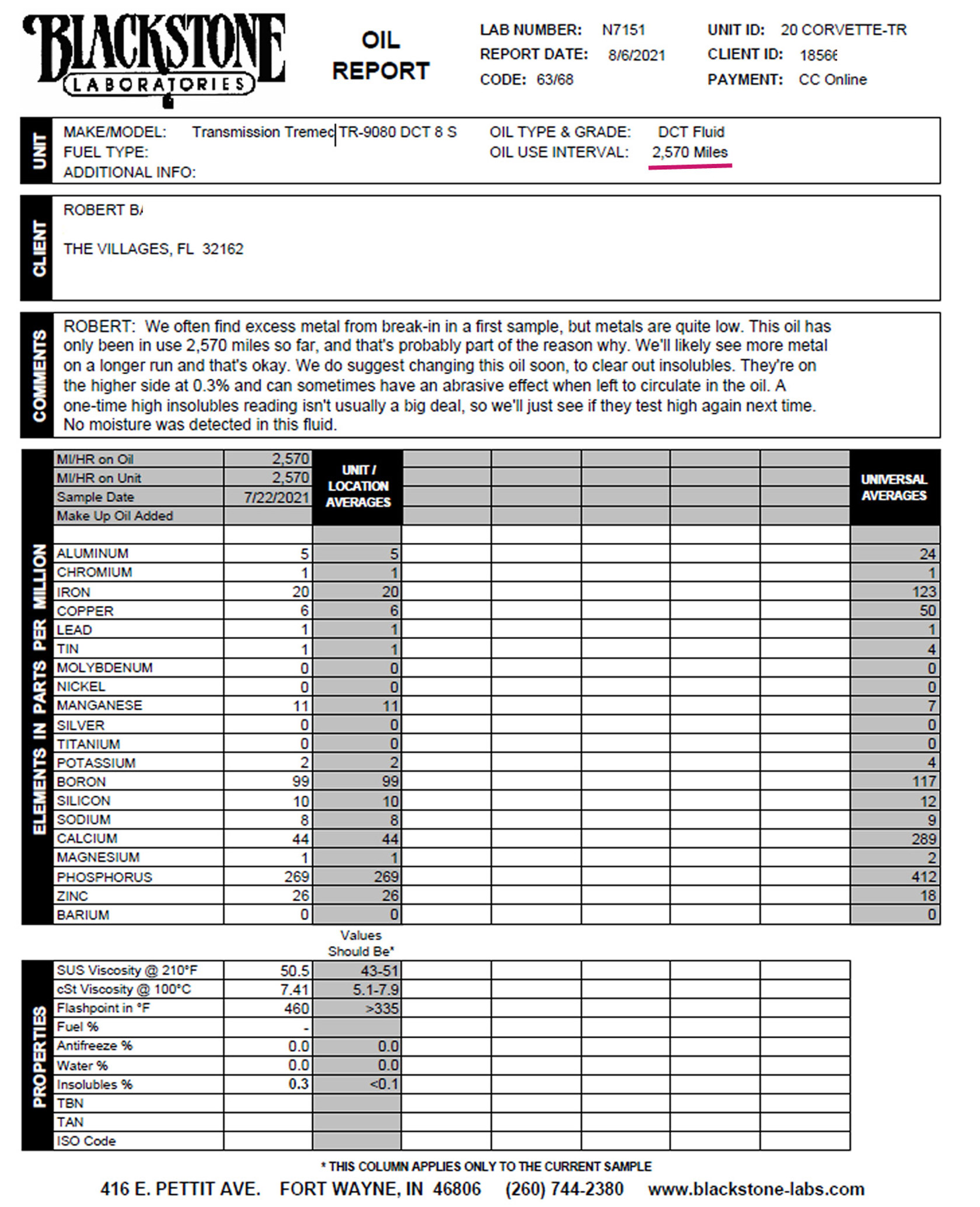

Teammate Bob B having 2,570 Miles on his 2020 C8 Z51 sent a sample of the used DCT fluid to Blackstone Test labs to analyze and report
Bob has done several hard launches and high RPM drives
Below is their findings :
The test lab will store the analyzed results on file so when Bob sends them other DCT samples as more miles are driven then Blackstone will compare the newest samples with older test samples of Bob's DCT fluid
And then analyze newer sent samples as received and then cross compare with the older samples Bob sends them
Over time, then Bob will be able to see if anything shows degrading before problems occur as Blackstone sends Bob PDF reports and
also maintains results on file for Bob
Here you see their findings and the types of metals seen in this first 2,570 miles driven but in short even with the few miles on this DCT fluid
they recommend the fluid be changed soon to flush out the metals seen now

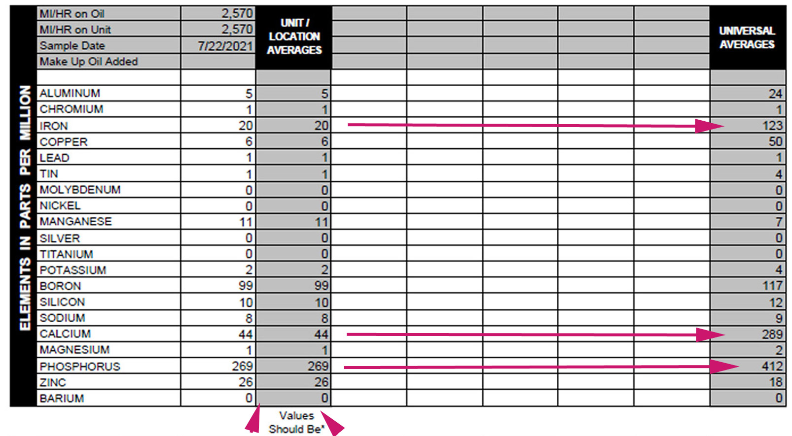

As you look over what the fluid makeup was in that sample
See there is too much
Iron
Calcium
Phosphorus
As to what the average percentage should be as seen on right side

Testlab explains the makeup of findings
Averages: Both the universal and unit averages are running averages and change with the number of samples we analyze.
Elements: Elements are quantified in the oil at parts per million levels (PPM).
This list shows the most common sources of the elements in manual or automatic transmission oil.
Following each element is a description of where it comes from.
They are grouped by category.
Wear Metals
Aluminum: Housing, bearings, oil pump, gear and vane pumps
Chromium: Ball and roller bearings, alloy of steel parts like gears
Iron: Gears, bearings, shafts, some cases, clutch plates
Copper: Bronze bushings, oil cooler oxides, clutch plates, brass fittings
Lead: Residual gear marking compound, alloy of bronze
Tin: Some bearing cages, alloy of bronze
Nickel: Clutch bands, gear/shaft steel alloy
Silver: Some soft friction bearings, Allison needle bearings
Manganese: Alloy of steel
Titanium: Trace wear metal
Contaminants
Potassium: Antifreeze
Sodium: Antifreeze, additive in some engine oils
Silicon: Airborne dirt, sealers, gaskets, sand-casted parts, and spray lubricants, antifreeze
Oil Additives
Boron
Calcium
Magnesium
Phosphorus
Zinc
Barium
Physical properties
Viscosity/Flashpoint: If a contaminant is present in the oil, the Viscosity and Flashpoint will often be lower than stated in the “Values Should Be” line.
A viscosity reading high or low may show oil oxidation.
Antifreeze %: Indicates the amount of antifreeze found in the oil.
A question mark means we found possible traces of coolant, but not enough to definitively say it’s there.
Water %:
Indicates the amount of water found in the oil.
Insolubles %:
Insolubles are solid materials present in the oil. They are typically free carbon from the oxidation of the oil itself, and accumulated metal in the system.
