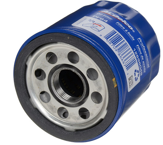

If an oil leak is seen, it may be coming from between the oil filter gasket and the mounting surface. (Fig. 15) The filter also may be very easy to remove, or may be able to be removed by hand.
The revised installation specification for all spin-on oil filters PF64, PF63, PF48, PF66, UPF64R, UPF63R, UPF48R and UPF66R is:
Lubricate the new oil filter gasket with clean engine oil. Install the oil filter one (1) full turn after the gasket makes contact with the sealing surface on the filter mounting flange. If installing with a torque wrench, it should be approximately 10 Nm of torque.
