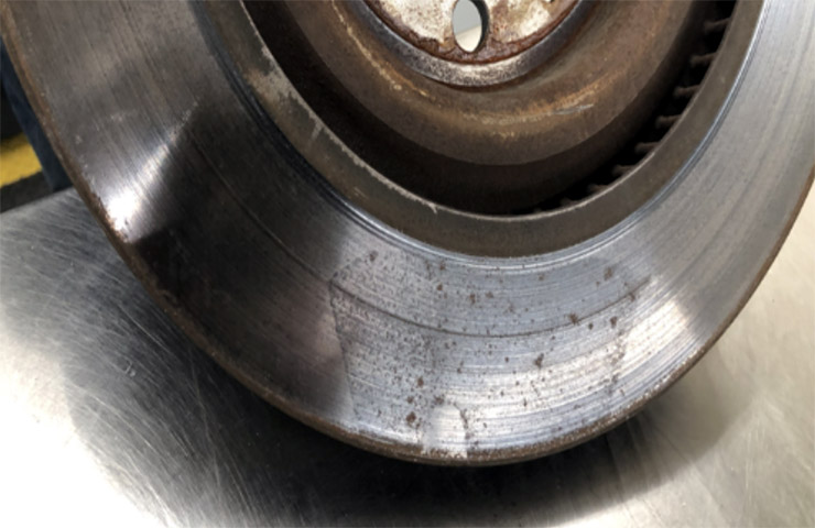

Some 2021-2022 C8 Corvettes equipped with the Z51 Performance Package may have a brake pulsation or grinding sound when applying the brakes. There also may be a pitting condition seen on the brake rotor surface. These conditions are most commonly found after the vehicle sits for an extended period of time, especially in high humidity.
TIP: These brake rotor conditions are outlined in the Owner’s Manual and should be reviewed with the customer.

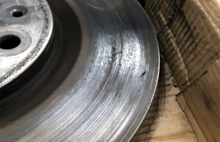

Typically, the brake rotor conditions are caused by corrosion pad spotting (Fig. 2) and surface grooving (Fig. 3) on the rotor surface. Burnishing the brakes can help to restore optimal brake performance and reduce brake noise.

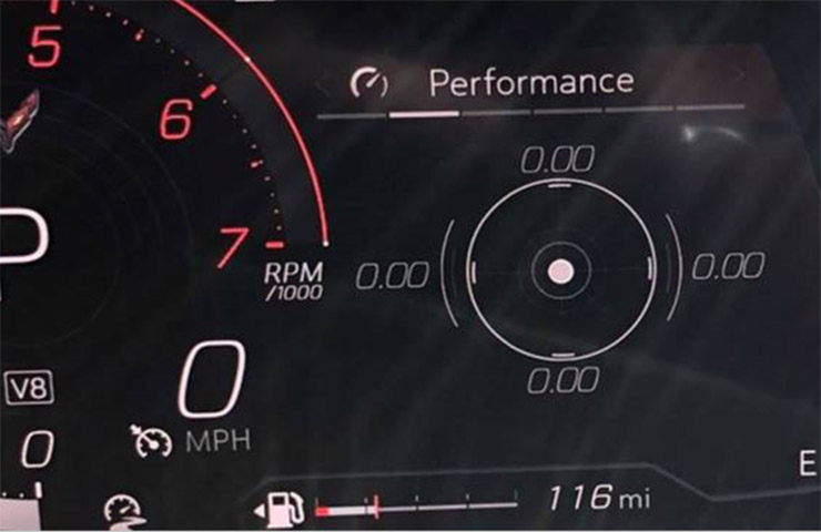

Refer to Bulletin #22-NA-026 and the Owner’s Manual for the complete brake burnishing procedure. The procedure includes applying the brakes 10 times starting at 60 mph (100 km/h) to 30 mph (50 k/h) while decelerating at 0.4g, which is a medium brake application.
The Friction Circle (or Friction Bubble), found under the Performance menu on the instrument cluster, can be used to monitor the g-force. (Fig. 4) Use the Driver Information Center (DIC) steering wheel controls to view the menus on the instrument cluster.
Between brake applications, the vehicle should be driven for at least 0.3 miles (0.5 km). While performing the procedure, the brake pads may smoke and produce an odor. The braking force and pedal travel also may increase. After the procedure, the brake pads may appear white at the rotor contact.
