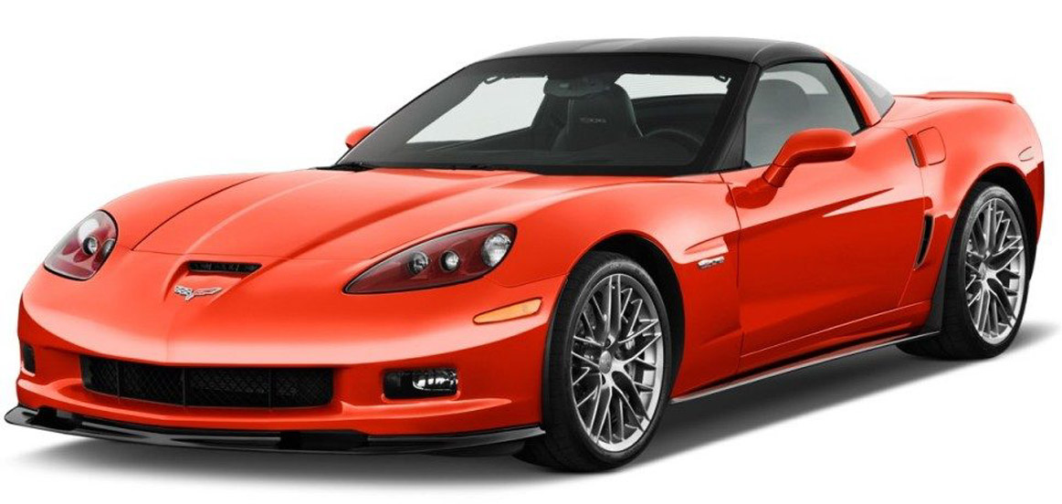

#5550 - 03/22/2212:31 PMC6 Z06/ZR1 Engine Bay Noise - TSB
Some owners of 2006-2012 Chevy Corvette Z06 or 2009-2012 ZR1 models may comment on a rattle or tapping noise from under the hood.
