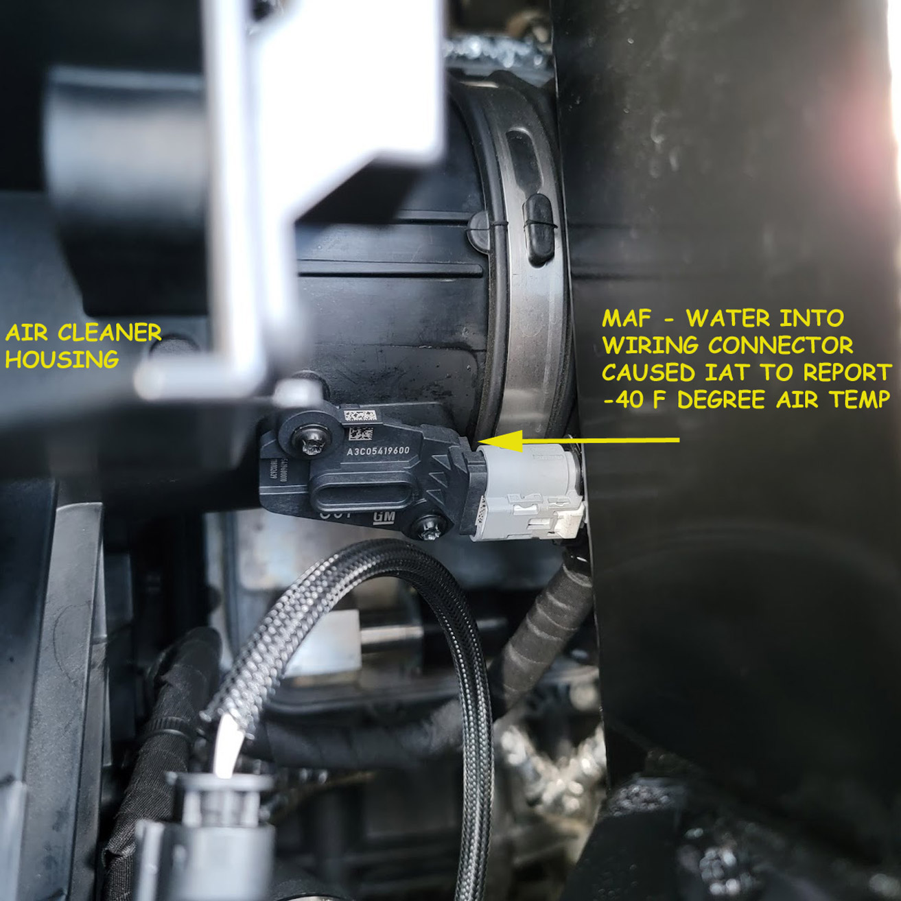

2022 HTC only 1,100 miles on it and while driving things started appearing odd and engine not running well Odd values showing on dash

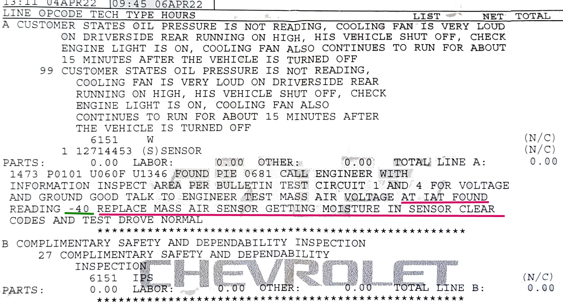

Owner takes to dealer to find that if rain water or washing C8 often water seeped into the wiring connector of the MAF This caused the IAT sensor in MAF to report intake air temp of minus 40 F deg which then of course PCM adjusting AFR incorrectly
If you're often washing, a C8 is assuring to limit water getting into engine bay
