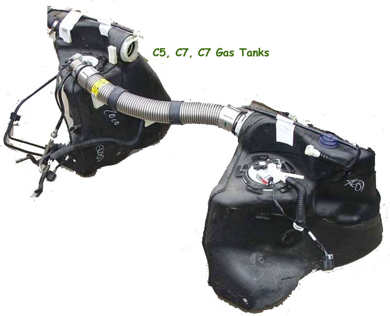

The C5,6,7 Corvettes has two fuel tanks, left and right hand. The left-hand tank contains the electric fuel pump that supplies fuel to the engine.
The right-hand tank has a pump, which transfers fuel from the right tank to the left tank. The pump in the right-hand tank has no moving parts and is not really a pump. It is a siphon device that uses fuel pressure from the left-hand pump to start a siphon that transfers fuel from the right-hand tank to the left-hand tank.
In order to create this siphon, the fuel line that goes to the engine splits and a small amount of pressure is routed to the right-hand tank to start the siphoning. The fuel that is being siphoned is routed through another hose to the left-hand tank. If the left-hand tank is full, the fuel transfers back to the right hand tank through the large filler tube located at the top of the tanks.

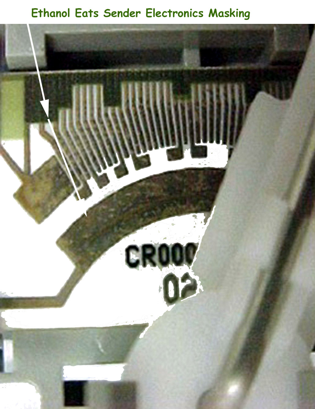

On some Corvettes, the situation that is occurring now is the result of the right hand sending unit being attacked by compounds within reformulated gasoline. This condition manifests itself as an erratic voltage signal from the right hand sending unit.
In the above scenario, left tank full and right tank empty, gauge at half, the computer looks for the voltage signal from the right-hand tank to stay below a preset level. The erratic voltage signal caused by the reformulated gasoline causes the computer to think there is fuel in the right-hand tank when there is not.
When this happens, the computer software turns on the Check Gauges light and commands the fuel gauge to empty. GM has issued a revised computer software, for 1999 through early 2002 models, that raises the right hand preset voltage empty limit to prevent the erratic voltage signal from causing this situation. While it has proven to be an effective solution, it has not corrected the concern in all instances
Keep on mind as I show below the use of E10 or E15 gas will cause the masking of the senders floats daughter board and cause incorrect amount of gas in the 2 tanks
