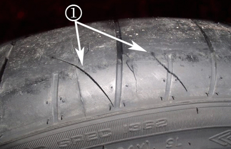

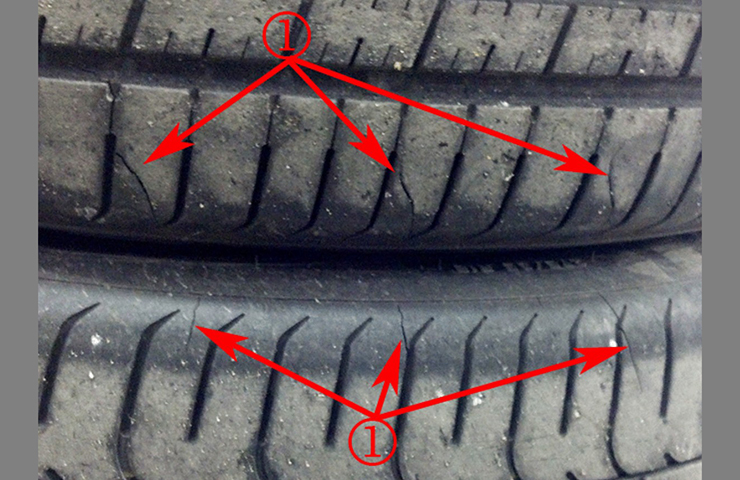

In colder climates, the special tread and compound used in high-performance tires will have decreased performance. In some cases, the special rubber compounds may lose flexibility in colder temperatures below 20°F (−7°C) and surface cracks in the tire tread/shoulder area may develop. (Fig. 2)
The surface cracks are cosmetic and will not result in a loss of air. However, they are damaging to the tire and cause a decrease in performance. Tires that have been used in cold climates and exhibit tread cracks (Fig. 3) should be discarded.
