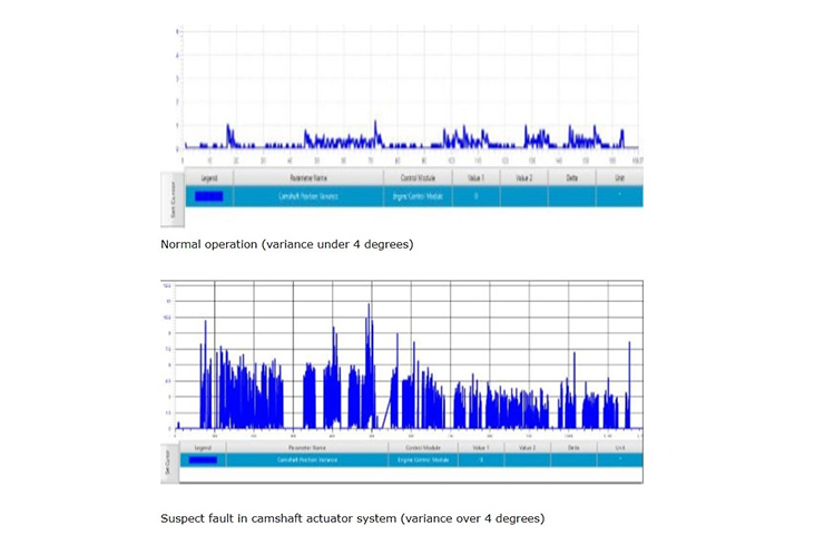

Monitor the Camshaft Position Variance data parameter in GDS2 while duplicating the shudder condition. The target variance is 0 degrees, but a variance up to 3-4 degrees may occur on a properly functioning system. Any variance exceeding 3-4 degrees may potentially cause a noticeable shudder or surge condition.
Following are line graph examples from GDS2 of the camshaft actuator system, showing normal operation (variance under 4 degrees) and improper operation. (Fig. 8) If the concern is isolated to the camshaft actuator system, replace the camshaft actuator magnet and evaluate system operation. Refer to Camshaft Position Actuator Magnet Replacement in the appropriate Service Information. For more information and part numbers, refer to Bulletin #22-NA-080.
