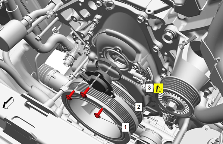

A shudder or surge may be felt when driving at a steady speed on some 2014-2022 Corvettes, Silverado, Sierra; 2015-2022 Tahoe, Suburban, Yukon, Escalade; 2016-2022 Camaro; 2020-2022 Silverado HD, Sierra HD; 2021-2022 Express, Savana; and 2022 CT5 models equipped with the 4.3L engine (RPO LV3), 5.3L engine (RPO L82, L83, L84), 6.2L engine (RPO LT1, LT2, LT4, L86, L87) or 6.6L engine (RPO L8T). The shudder condition may be caused by the camshaft actuator magnet sticking. (Fig. 7, #2)
