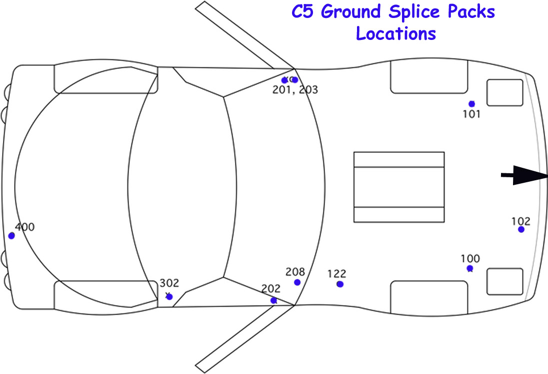

Splice Pack 100 (with ground tab)
Location: Engine compartment, on top of the right frame rail, just behind the right headlight
Circuits: horn, right headlamp door, underhood lamp, headlamp door control module, fog lamps, A/C compressor clutch, AIR pump, Splice Pack 102. Note: the stud attaching the ground tab to the frame can get corroded and easily snap off if you are not careful.
Splice Pack 101 (with ground tab) Location: Engine compartment, on top of the left frame rail, just behind the left headlight
Circuits: brake fluid level switch, washer fluid pump, washer fluid level switch, left headlamp door. Note: the stud attaching the ground tab to the frame can get corroded and easily snap off if you are not careful
Splice Pack 102 (no ground tab)
Location: taped to the front lamp sub-harness under front bumper, right side. Access requires the removal of 10 7mm body screws holding the bottom of the plastic bumper to the radiator air guide and some under-body trim below the left headlamp.
Circuits: both front marker lamps and both front park/turn signal lamps. Note that this Splice Pack gets its ground from Splice Pack 100.
Splice Pack 122 (no ground tab) Location: under the battery tray, taped to harness next to firewall.
Circuits: fuel pump relay, oil level switch, Oxygen (O2) sensors. Note: while you are here, check the harness for abrasion and acid damage. Some cars experienced battery leaks which may have damaged the harness.
Splice Pack 201 (with ground tab) Location: Base of left (driver side) A pillar (by hood release latch), next to Splice Pack 203.
Circuits: Air temperature actuator, data link connector, instrument panel cluster, traction/suspension control switch, driver door module, left door latch, auxiliary power drop connector, wiper motor, steering column lock, left footwell courtesy lamp, hazard switch, telescopic actuator switch.
Splice Pack 202 (with ground tab) Location: Base of right (passenger side) A pillar.
Circuits: HVAC control module, ignition switch, body control module, Bose relay, glove box lamp, right footwell courtesy lamp, A/T shiftlock control solenoid, blower motor control processor, vanity mirror lamps, inside rearview mirror lamps, blower motor relay, cigarette lighter, passenger door module, passenger door latch.
Splice Pack 203 (no ground tab) Location: Base of left (driver side) A pillar (by hood release latch). Next to Splice Pack 201.
Circuits: remote CD changer, front door speakers, radio.
Splice Pack 208 (no ground tab) Location: behind right side of dash, taped to harness above electronics in foot well.
Circuits: Park/neutral switch, Data Link connector, instrument panel cluster, airbag module, Body control module, remote control door lock receiver.
Splice Pack 302 (with ground tab) Location: in passenger compartment, behind passenger door opening rear trim.
Circuits: Rear compartment (or folding top) lid latch, lid release switch, both rear compartment courtesy lamps, fuel door lock actuator, passenger seat pump and relay center, radio power antenna.
Splice Pack 400 (no ground tab) Location: taped to rear body harness on right side. Access requires the removal of the right backup lamp.
Circuits: All rear lamps (tail/stop, turn, marker, license plate, backup, center stop), rear compartment right courtesy lamp.
