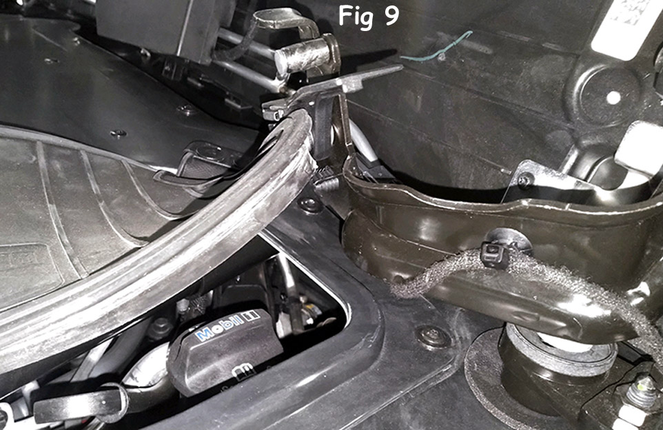

Some 2020-2022 Corvette Convertible models may have a power folding top that may not open. DTC B19E1 (Hard Top Stowed Signal) may be set. If the folding top will not open, it may be due to the body-side frame access hole plug not being properly seated. (Fig. 9) The plug, or rubber flap, is located in the engine compartment and may interfere with the B373 Folding Top Side Rail Roof Panel's Stowed Sensor.

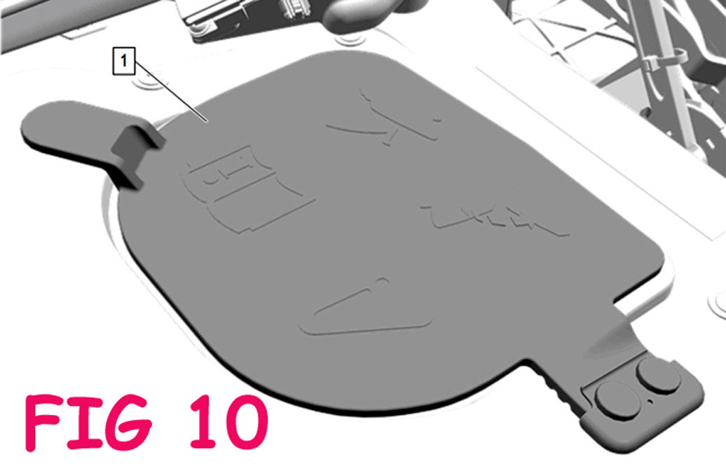

The body-side frame access hole plug should be fully seated anytime the plug is removed, such as after an engine oil change. The oil fill cap is located under the access hole plug. (Fig. 10)

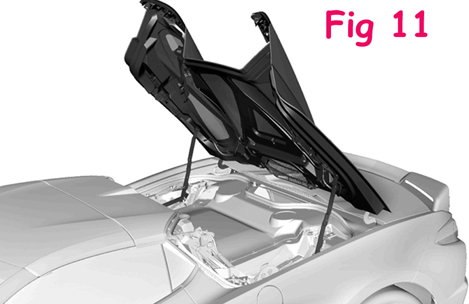

To verify that the access hole plug is fully seated, open the folding top stowage compartment. (Fig. 11) Refer to Opening the Folding Top Stowage Compartment Lid – Engine Access section within Folding Top and Folding Top Stowage Compartment Lid Operation in the appropriate Service Information.
