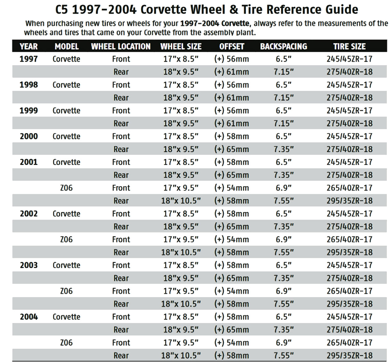

C5 Corvette - Wheel, Tire & Offset Specs
If you need to know the GM OEM specs for Gen 5 Corvettes
as to wheel & tires size along with the offset & backspacing
