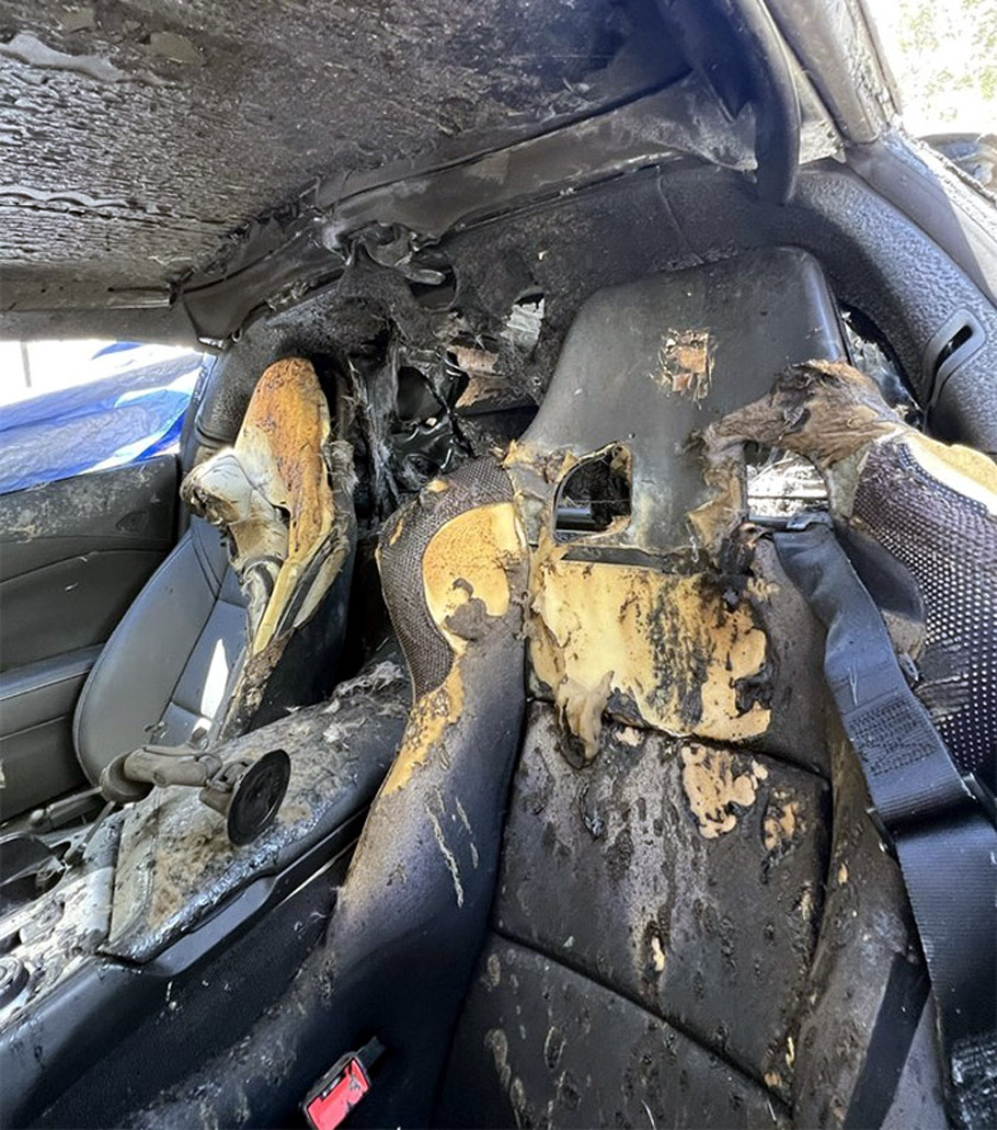

It was so smoky inside the cabin that he says he had a hard time breathing. After immediately undoing his six-point harness, he couldn’t get the door to open and had to use the manual lever. Upon exiting the vehicle, he spotted small flames dropping below the car in the right rear.

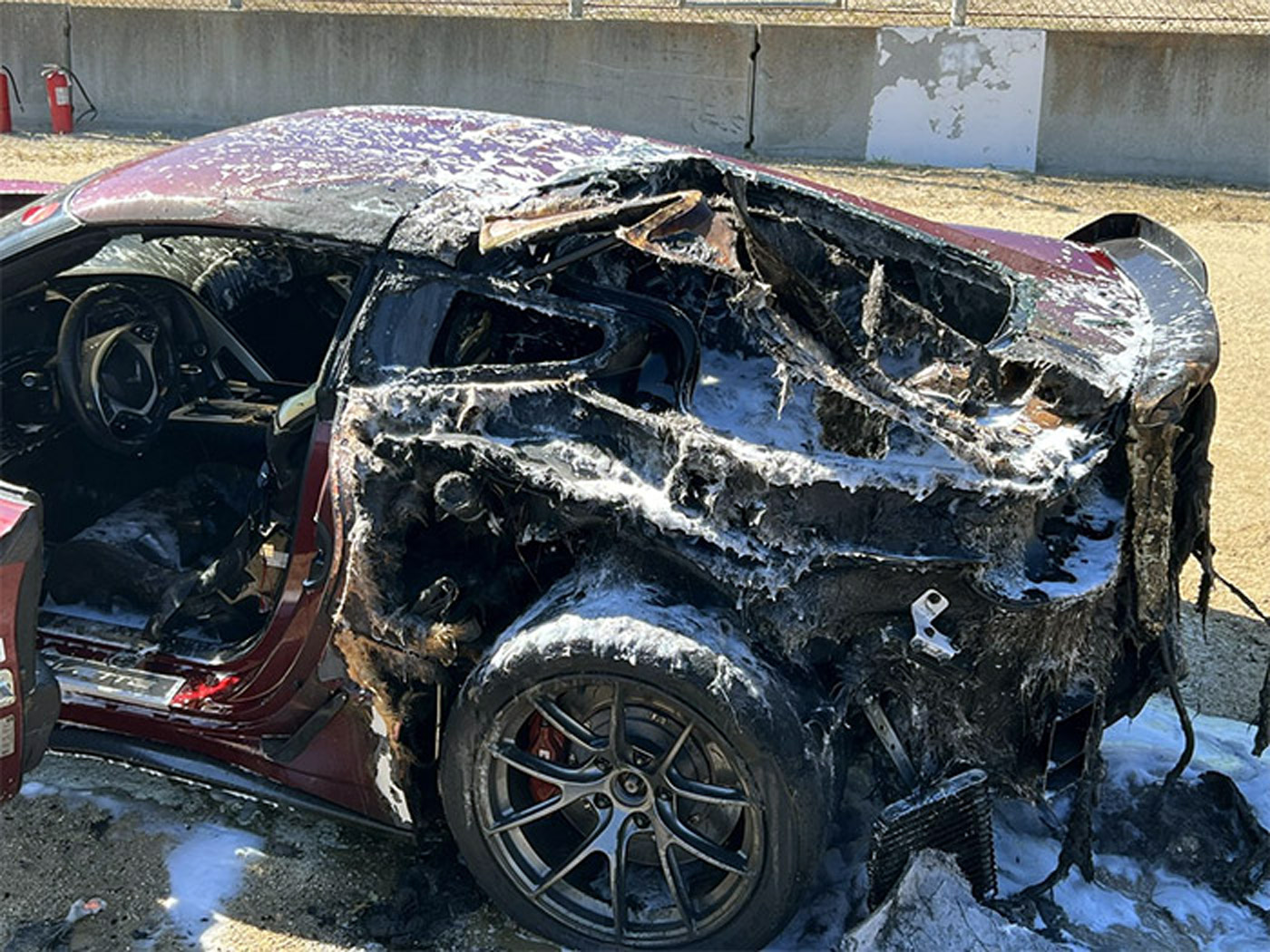

As you can see in the accompanying photos, the car soon turned into a healthy ball of fire. “Fire dept arrived very quickly,” he posted. “The fire started in the right rear and moved over to the left rear when it really got going.”

As for the cause of the fire, dllhg says the firefighters don’t think it was fuel nor a bad aftermarket battery. He believes it might be related to the trans line in the right rear, as 2017 and older cars have a small flex section with no heat shielding (2018 and above do have heat shielding, by the way.) “Thanks for the afterthought, GM,” he jokes.
“Lots of heat up in there from exhaust, maybe the line got brittle and finally sprung a leak? Differential seems less likely. On the left side was a trans cooler. I’m guessing once the fire got bigger it jumped over there, won’t ever know for certain.”
