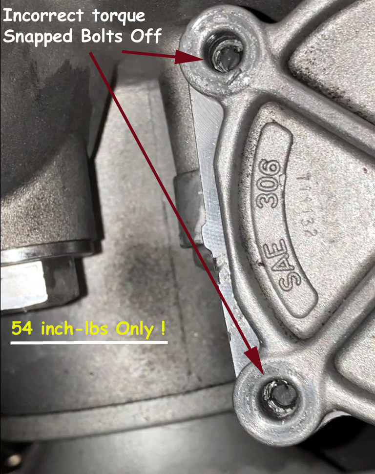

What not to Do when changing DCT Filter
C8 owner decided he would change the external filter of DCT
Clearly over torqued the bolts and snapped them off in the filter case
