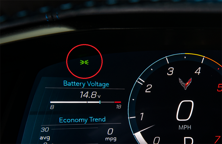

For 2023 model year Corvettes with the headlamp operation condition, updated software may not be available yet. For these vehicles, it is recommended to check the headlamp switch setting and for an illuminated Lights On Reminder symbol on the instrument cluster to ensure the headlamps are on when driving in low lighting conditions. (Fig. 7)
