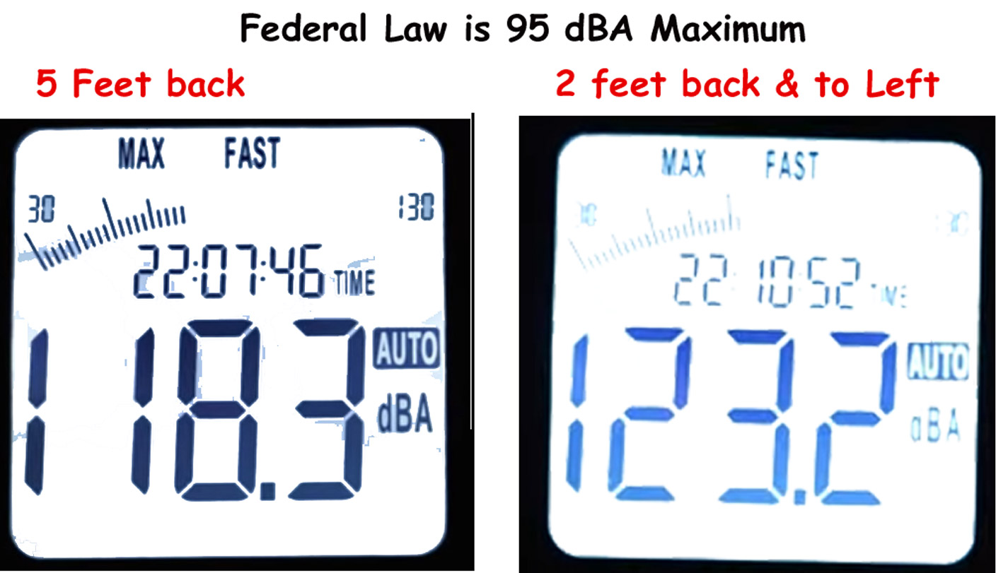

Look at the 2023 Z06 Corvette with stock exhaust results at the bottom of this
The Dba even 5 feet back is way over federal law allows and even worse 2 feet away from exhaust tips
I know what loud is in designing my custom exhaust system for my C5 and then a lot of long term testing :
In testing, the sound as to DbC level is too high,
average inside the car with windows up is about 110 DB and as much as 128 DbC near the rear wheels.
Measuring as to ear quality levels as DbA inside measured 92 and outside 102 DbA.
We want final design under 95 DbA and less than 85 DbA inside.

2023 stock Z06 dBA readings while parked
