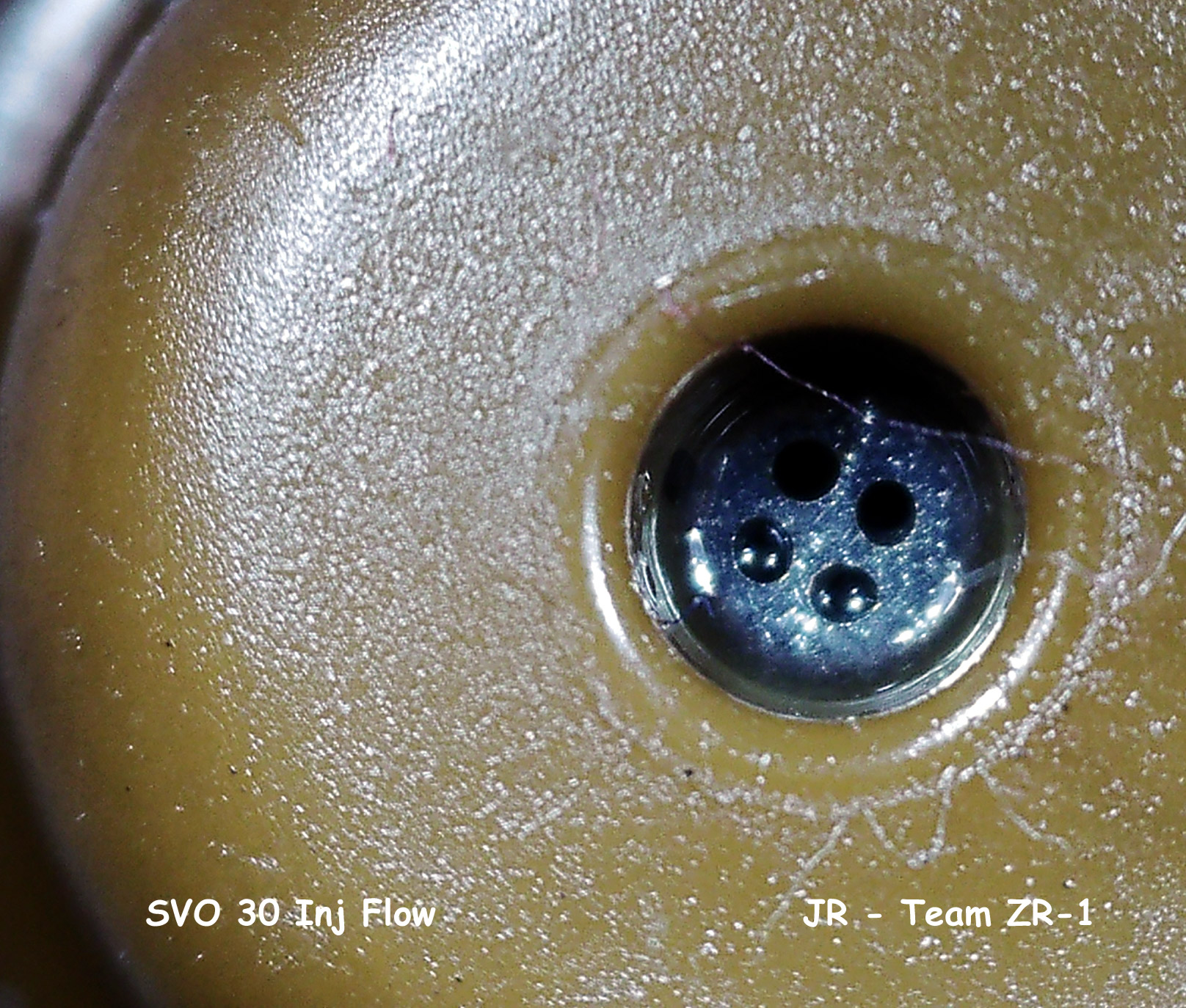

The three styles of fuel injectors I tested, looking via under a microscope
C4 ZR-1
SVO 30
C5 Z06
