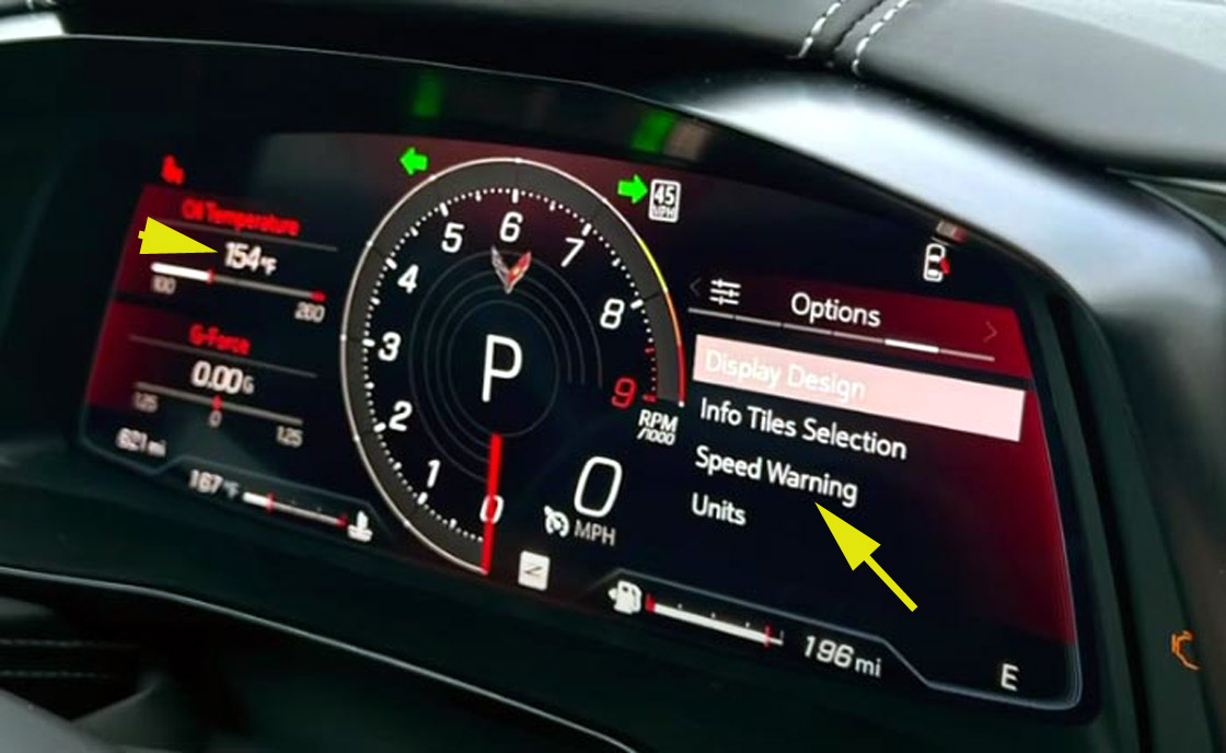

Here’s the owner telling us in his own words about the failure at only 621 miles :
In this video, the owner claims of what was going on with the car when the failure happened, and the incident is backed with video from just happens to have a GoPro already mounted which captures the moment the engine crapped out. There’s also a photo they took of the dash as the engine failed and the oil temp was only 154 degrees.
I did a slight pull from first, second, third.
The street kind of veers to the left, then I get back into the throttle for a bit, and we decelerate to a stop sign, and as we were decelerating, we heard a clunk, clunk, clunk, and I couldn’t believe what I was hearing.
Since we were so close to Jay’s house, I pulled a U-turn and the car locked up. So, we got a scan tool, and [it showed] misfires on one, two, seven, and eight.
At this point, the owner details his break-in procedure for the car, claiming it was essentially babied during that first 500 miles, and he was always diligent about warming up the engine before driving and keeping the revs under 5,000 RPM.
