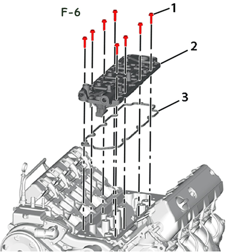

The part numbers have been updated for the individual components that were previously included in the valve lifter oil manifold (VLOM) kit. With the updated part numbers, select only the parts that coincide with the repair being performed. The VLOM should be replaced only if it tests faulty. (Fig. 6) Bulletin #15-06-01-002O includes an updated parts list. Replace the part with the P/N outlined in the Electronic Parts Catalog (EPC) in accordance with the vehicle VIN. Check Valve Lifter Operation

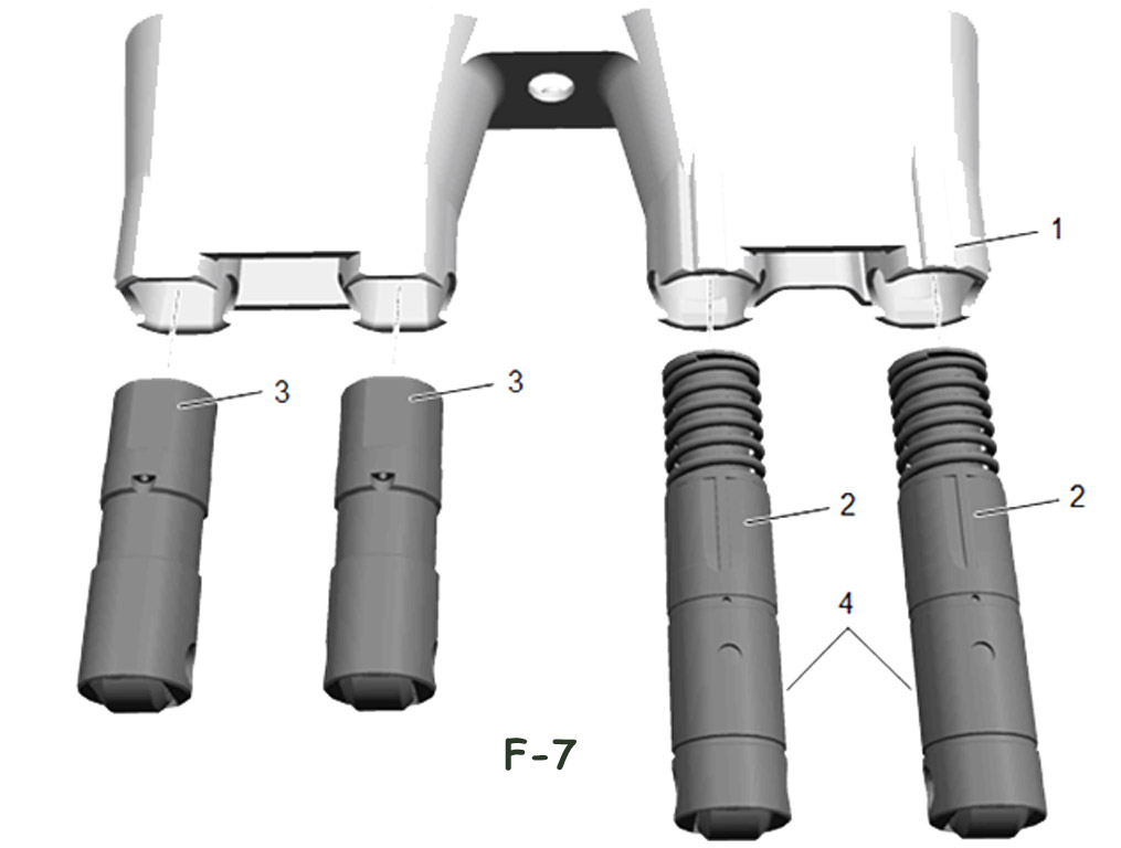

TIP: Any time a lifter is replaced, the lifter guide also must be replaced. (Fig. 7)

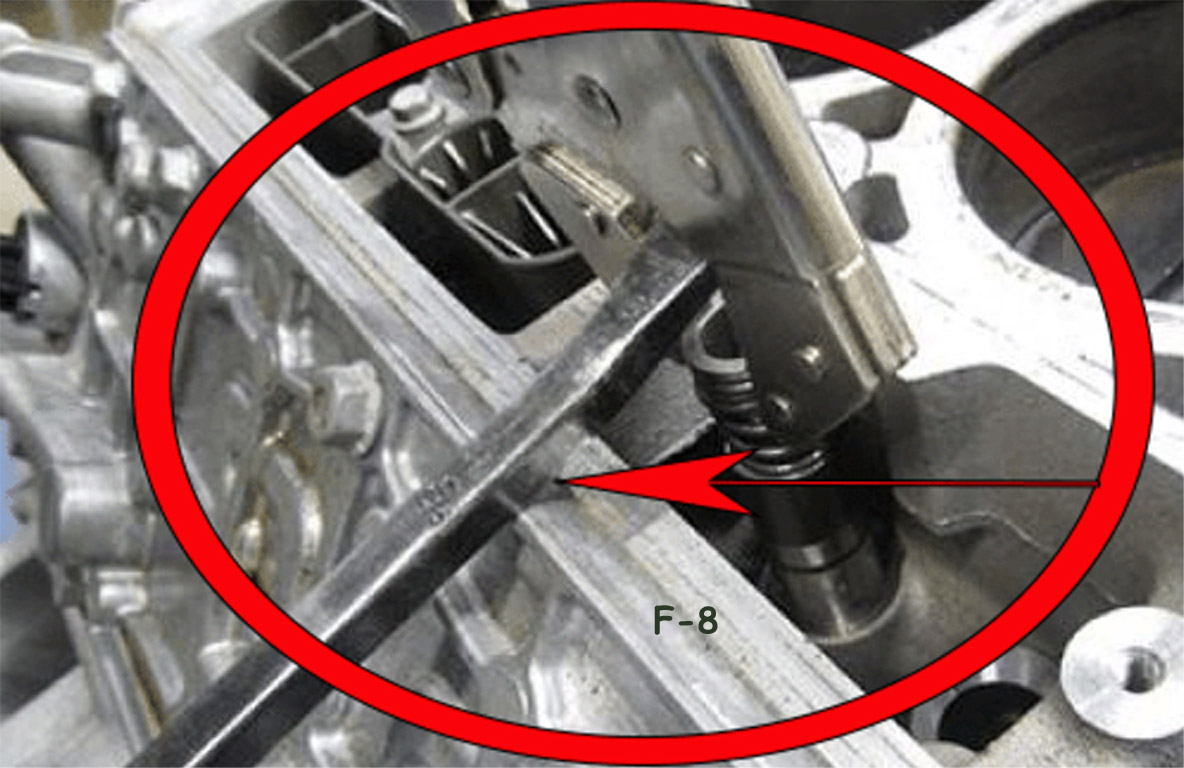

If a lifter is stuck in the bore, use vice grips with a slide hammer or a small pry bar to remove the lifter. Do not pry on the sealing surface of the block when removing a lifter. (Fig. 8)
