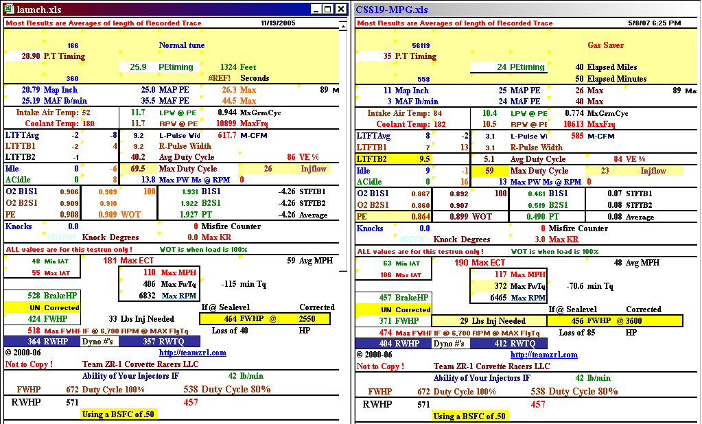

Starting with end results.
If we believed the forum hypes to have a perfect tune you must have the LTFTs at part throttle rich (negative values) in these test results shows that is bullshit.
On the left we have results were the LTFTs are rich and on the right side results we tuned to be about 10% leaner and you'll notice the injector duty cycle was reduced from 70% to 59% which means not only are injectors not working as hard but also flowing less gas but overall in in high engine loads the gas saver tune only lost about 15 HP at flywheel.
For daily driving then tuning to be leaner will save a lot of gas costs long term for very little loss of performance.

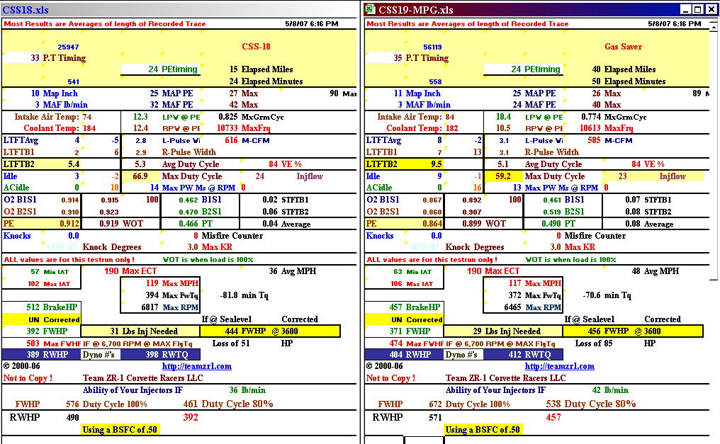

Here is testing where on left we set for 5% leaner and then on right is for 10% leaner and notice there was no real performance loss at all at the required injector size needed is reduced.
[Linked Image]

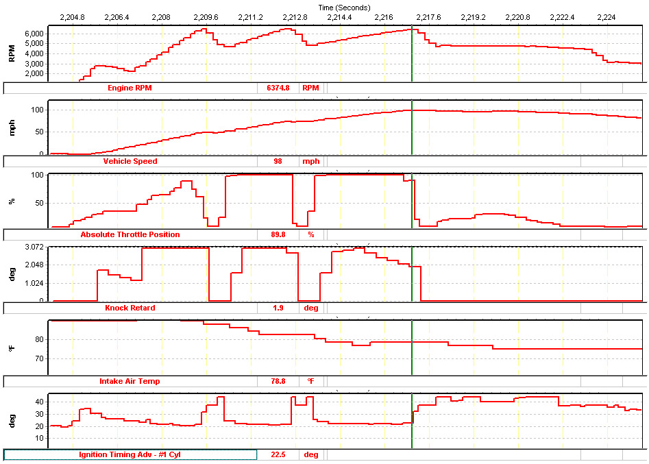

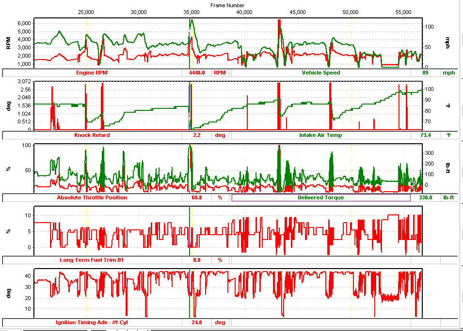

Here we can see the OBD-II realtime data where was see what little ping there was when the water/methanol injection came on the ping instantly went away and also due to the tune the attack and decay rate of ping is very quick.
[Linked Image]
Here we see even when there was ping that timing only decreased less then 3 degrees
[Linked Image]
